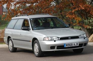

LegacyT Posted October 31, 2003 Share Posted October 31, 2003 They came in the 91-94 Legacy turbo, these guys: Mark, Quote Link to comment Share on other sites More sharing options...
