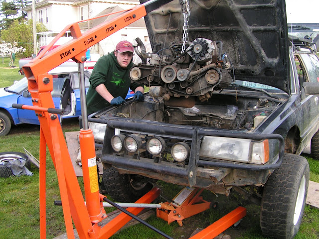

so i made a lot of progress today. i got the steering linked together and the motor back in. tomorrow should be the last day of work and then it is time for me to re-do some of my crappy electrical work
Posted Image
Posted Image
Posted Image
Posted Image
Posted Image
Posted Image
what parts are those for that steering? looks like all boltup no weldin

according to GD, not until i replace those blocks. and in that last picture, i am sitting on the floor. i haven't put in the new RX seats yet. And it's raining so now i cant weld the tranny links today.
it is. i modified the steering linkage from my old non power steering crossmeber to bolt onto the linkage on the new crossmember with power steering. took me about 10 minutes to cut it and install. no welding involved, all bolt together
