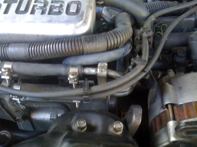

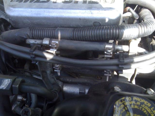

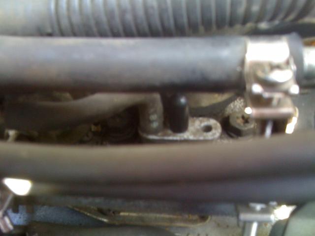

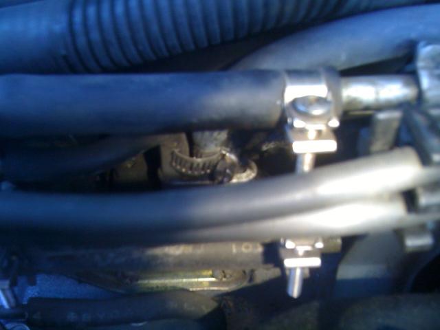

eulogious Posted September 30, 2009 Author Share Posted September 30, 2009 (edited) Here is where the vent hoses connect to the engine. Is this my problem... Here is a zoomed out shot of where they attach Here is where they connect to the hose connecting to the engine And finally the driver and passenger vent hose locations that I found Edited September 30, 2009 by eulogious Quote Link to comment Share on other sites More sharing options...
eulogious Posted September 30, 2009 Author Share Posted September 30, 2009 (edited) Mine doesn't have a tee that connects to the engine, but it is an '88 (the first year for 4EAT ). If you want, you can just leave the vent hoses off. If you don't go in deep water it shouldn't be a problem; you might see a bit of ATF where the vent nipple is but it won't be much. Not sure why the other side is clogged but if only the tranny side has problems (the dipstick popping out) leaving the hoses off should fix it. I guess I should have clarified myself a bit better, the hose isn't clogged, it's in the tranny that is. That's why I mention the tranny flush I tried to stick some thin wire down the vent hole, but that didn't solve anything... So I don't have to plug off where the hose is connecting to the engine? I don't want to cause any vacuum issues. I already have to deal with this So '88 was the first year for the 4EAT, I was close Damn you google for telling me lies! Edited September 30, 2009 by eulogious Quote Link to comment Share on other sites More sharing options...
eulogious Posted September 30, 2009 Author Share Posted September 30, 2009 (edited) Ok, so I disconnected the hose from the motor and went on the same drive that I did yesterday, and the dipstick didn't get pushed out like it did yesterday!! But I don't want to be too excited yet, I have to put some more miles on it to make sure it's solved. There is a couple of things that I noticed when I disconnected the hose. First, the hose was about 2 size larger then the nipple it was connected to, hence the hose clamp on it :| Second, when I blew into the hose connected on the engine, air passed through, but it seemed like it was leaking out some where, not flowing freely like I excepted it to, so I think that it was leaking out by the hose clamp, but it was restricted enough to not let the tranny vent when it needed to, which caused the dipstick to get pushed out. Also, it now shifts great from first to second. It used to make a slight "clunk" from first to second, but not anymore. I guess that's just an added benefit for having the transmission being able to breath correctly. I am just happy that it was a super easy fix, and I solve 2 problems at once Is it possible that having the tranny vent properly would cause the clunk to go away? And finally, does anyone know what is supposed to be connected there, if anything at all? Here's a few picks showing the location. I eneded up putting a cap over the nipple. That's the black thing in the picture. How it was before: And now: Edited September 30, 2009 by eulogious Quote Link to comment Share on other sites More sharing options...

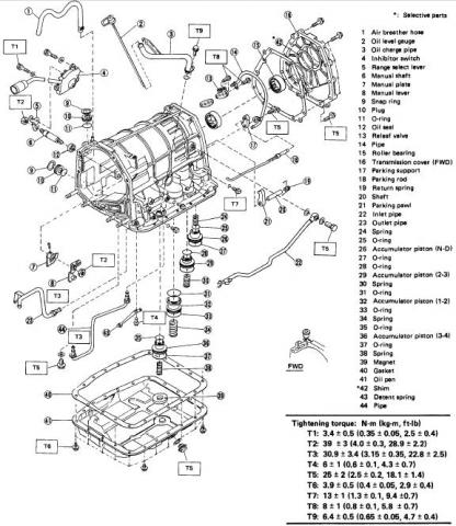

keppelk Posted October 2, 2009 Share Posted October 2, 2009 (edited) Awesome how this thread got up to 12 posts before someone spotted 4EAT is electronic! lol Always good to check out the FSMs to see what should be there, rather than what is there Looks like there should just be a short length of hose to allow venting without sucking in crud. IMO should cap any vacuum lines and run a short vent hose similar to the factory setup. Edited October 2, 2009 by keppelk Quote Link to comment Share on other sites More sharing options...
