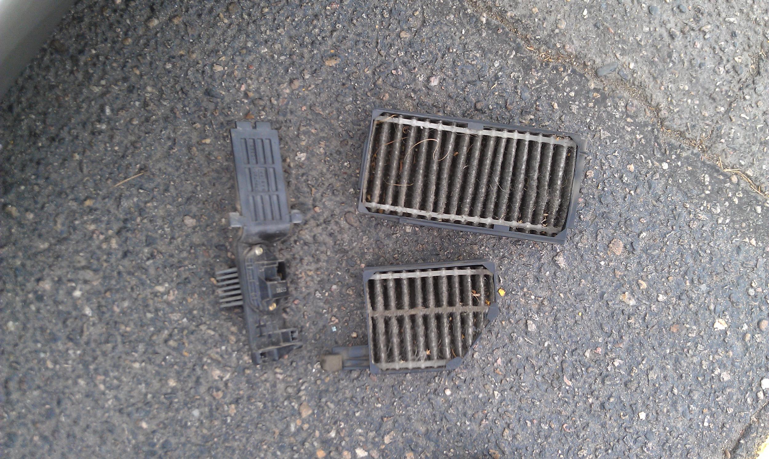

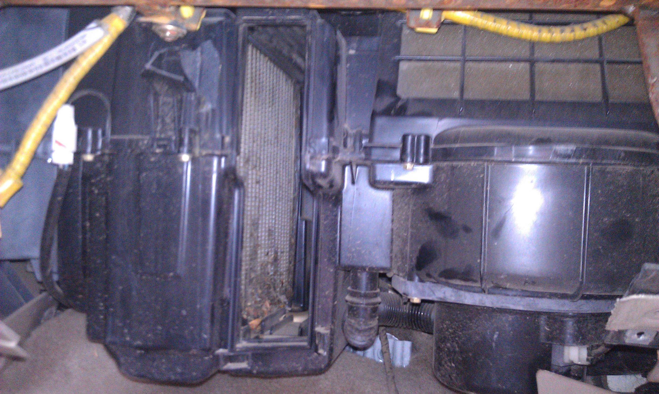

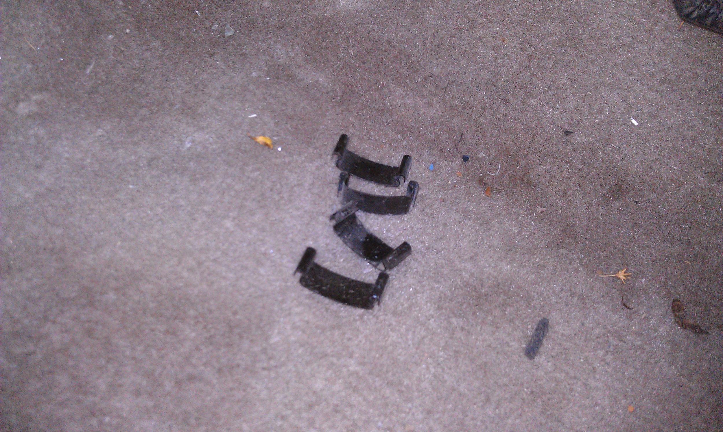

ShawnW Posted August 23, 2012 Share Posted August 23, 2012 Just had a phone call where someone was asking how/where the filter is. Remove the glovebox. Its pretty obvious once you open it remove the 6 or so screws and pull it and its rear surround out. Now you have the blower motor, resistor, and such exposed. The filter goes behind the plastic that the resistor block is screwed into and the panel has 4 clips that you can pop off into your eyeball with a pocket screwdriver. Clips are shown in the photo. Then the plastic can slide down 1/4" or so and you can pull on the resistor plug in to get the whole thing to come off. Now grab the lower filter followed by the upper filter. MSRP on the filter kit is $39.95. I have them here for $24.88 from an OEM supplier. These have the plastic pieces. Some people have had success in using furnace type filter media and installing it into the original plastics if your car has the filter "kit" already. Quote Link to comment Share on other sites More sharing options...
john40iowa Posted August 24, 2012 Share Posted August 24, 2012 Thanks for the photos. I have decided to live with mine sans a filter. My next Forester will have one! Quote Link to comment Share on other sites More sharing options...
