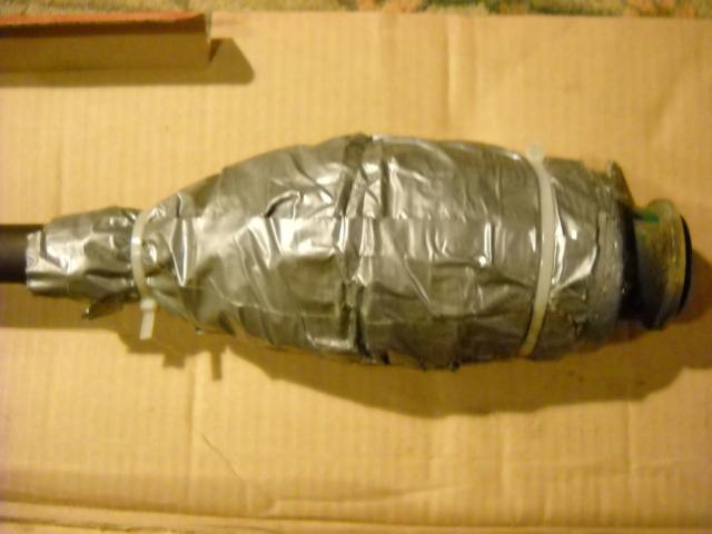

Ok, so I was changing my ball joints and noticed that both front cv axles have tears in the boots. Just enough to where grease has barely started to come out. My big concern is with heading up in the snow and pass on the 6th with the X-mas tree run. No knocking or sound of the joint going out itself. I just dont want salt and crap to get in it. Would just a replacement cv axle boot work from Schucks until I can change the whole axle? Like I said, I am not looking to get crazy with the offroading just want something that will get me up there and back without putting alot of crap inside the axle. Anyone ever dealt with temporary boots before? good or bad? :-\

so, okay, your boots are cracked-but until your new axles arrive you can protect the joints. just cover them in heavy plastic and duct tape. will last a week. I've also squeezed a little extra grease into the joint for any that I lost.

I've run into the same problem in the past, winter weather, no time to replace the boot. I used comercial shipping wrap, turning to wheel in the direction of travel, applied over the whole boot. That way it didn't unwind goin' down the road. Held it on with a few zip ties, and got several months out of it. Luck. Steve.

temp cv axle boots = roll of duct tape. clean off both sides of the broken boot. start the duct tape on the small size of the boot (with the car jacked up ofc) and then have a friend put the car in first gear. spin on the duct tape til the boot is fixed.
ran a rear axle like this all through mud season this year. changed it a few weeks ago. lol duct tape pwns

that may work on the rear but on the front the tape will quickly bunch up in the folds. the better way on the fronts is to tear equal length strips and overlap about 1/2 the strip lenthwize, wrap a length on the ends and zip tie. (heavy mill plastic underneath)
