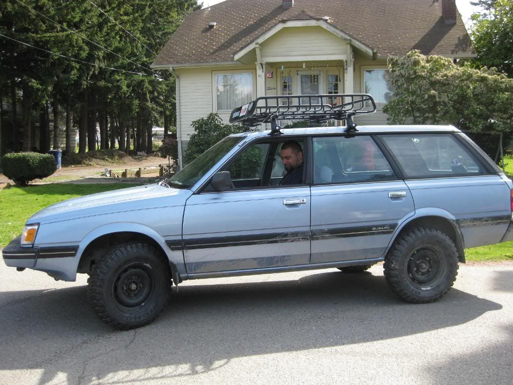

The Dude Abides Posted February 9, 2010 Share Posted February 9, 2010 2 inch lift with the tempo / accord spring trick. Totaling 3 inches. Quote Link to comment Share on other sites More sharing options...
bheinen74 Posted February 9, 2010 Share Posted February 9, 2010 lifts need to be done using combo of blocks for the crossmemembers and longer struts, or blocks, or you just are eating axles like candy. Quote Link to comment Share on other sites More sharing options...
one eye Posted February 9, 2010 Share Posted February 9, 2010 lifts need to be done using combo of blocks for the crossmemembers and longer struts, or blocks, or you just are eating axles like candy. As long as you stay at 2" you should be fine, anything over that you run into problems........... Jeff Quote Link to comment Share on other sites More sharing options...
The Dude Abides Posted February 9, 2010 Author Share Posted February 9, 2010 Are you saying that would work for 3inches of lift Quote Link to comment Share on other sites More sharing options...
bheinen74 Posted February 9, 2010 Share Posted February 9, 2010 yeah probably, but tire wear may increase some with DD chores. Quote Link to comment Share on other sites More sharing options...
one eye Posted February 9, 2010 Share Posted February 9, 2010 Are you saying that would work for 3inches of lift It might but your tires are going to look like this in the front \--/ and it will ware the hell out of them, you really need 15* angle inward to get your tired square to the ground.............. Jeff Quote Link to comment Share on other sites More sharing options...
The Dude Abides Posted February 9, 2010 Author Share Posted February 9, 2010 Alrighty ill just stick with the 2 inch until i can afford something bigger. But then again you PNW boys dont seem to need much more sometimes. Quote Link to comment Share on other sites More sharing options...
Breeke Posted February 9, 2010 Share Posted February 9, 2010 just pick up a 4" lift, they are fair priced.....then....all problem solved.... Quote Link to comment Share on other sites More sharing options...
The Dude Abides Posted February 9, 2010 Author Share Posted February 9, 2010 Yea, no point in lifting that big if i cant afford the tires for it. Just looking for something simple and was curious if anyone had tried this yet. Quote Link to comment Share on other sites More sharing options...

Markus56 Posted February 10, 2010 Share Posted February 10, 2010 Don't lift the struts more than 2 inches without a body lift. I break axles and stub shafts driving on pavement with my combo of a 2" lift and 2wd struts in the rear (about 1 1/2" longer than 4wd struts) Quote Link to comment Share on other sites More sharing options...
bheinen74 Posted February 10, 2010 Share Posted February 10, 2010 (edited) Don't lift the struts more than 2 inches without a body lift. I break axles and stub shafts driving on pavement with my combo of a 2" lift and 2wd struts in the rear (about 1 1/2" longer than 4wd struts) thats good info. thanks for the truth. will save someone alot of money. so far, best answer for bigger tires is cut the piss out of fenders to fit big tires. also, staying on topic sort of, anyone who lifts a 1982-1987 BRAT with a 4" lift can only fit 3.5 inche bigger diameter tires than stock without cutting. For more clearance, just fit 25.5 inch tires without lift, you get same results that a 4" lift gives you of 27.5" tires vs 23.5 sotck tires. so. I love these types of threds. if you want bigger tires or lift, then get 1.75 inch taller tires and trim to clear, or get a 4" lift and get 3.5 inch taller tires.....there. sorry to hijack ... was a ruf day Edited February 10, 2010 by bheinen74 Quote Link to comment Share on other sites More sharing options...

The Dude Abides Posted February 10, 2010 Author Share Posted February 10, 2010 so, where did it come from? You just randomly guessed at some springs from some other cars and asked? :-\ No i had read in the past here about useing accord springs up front and tempo springs in the back or vice versa to get an xtra inch of clearance. And Markus56 that is exactly the answer i was looking for. Overstreaching the axels. Point taken and will purchase a proper lift when funds available. Thank you all for your imput. Quote Link to comment Share on other sites More sharing options...
one eye Posted February 10, 2010 Share Posted February 10, 2010 You could ask Uberoo, I think that car that I picked up for Scott that Uberoo built had this set up on it, Or Scott might still have it, It just an Idea. If it is 1" that shouldnt hurt any thing, but you would only need it on the rear struts if that was the case, you could just use adjustable struts in the front and tighten the nuts up a bit to bring the front up. All said and done you could fit 27's or 195/75/14-205/70/14's on with very little trimming. Now I'm just rambling on but ask Uberoo or scott what is the deal with that old EJed Blue wagon that had that set up back in the day on it. Jeff Quote Link to comment Share on other sites More sharing options...
The Dude Abides Posted February 10, 2010 Author Share Posted February 10, 2010 I can get the setup i want buy just getting the 2inch lift. I was just curious if anyone had tried that. I doubt i could even find a late 80s accord in the jy anymore. But this is how i want my lift and tires to turn out. I think you recognize the handy work oneeye. Quote Link to comment Share on other sites More sharing options...

Uberoo Posted February 10, 2010 Share Posted February 10, 2010 tempo springs, use the front springs from a ford tempo.I don't think engine really matters much because they all came with the same engine.It IS possible to use tempo springs as a 2" lift or there abouts on the front.I cut a whole coil off the top of them and that got me 1" of lift even with the EJ in there. accord springs,use accord front springs off a car with an auto and AC.They go on the rear of a wagon,also giving about an inch of lift. In theory you should be able to use the springs and a two inch lift to get 3" lift.Then run a 1" block under the engine/tranny and rear diff to make the angles more bearable. with that extra lift it should be easier to fit some tires... 3" of suspension lift seems like it would eat axles like candy.like my 2" lifted EA81 is supposed to do... Quote Link to comment Share on other sites More sharing options...

The Dude Abides Posted February 10, 2010 Author Share Posted February 10, 2010 tempo springs, use the front springs from a ford tempo.I don't think engine really matters much because they all came with the same engine.It IS possible to use tempo springs as a 2" lift or there abouts on the front.I cut a whole coil off the top of them and that got me 1" of lift even with the EJ in there. accord springs,use accord front springs off a car with an auto and AC.They go on the rear of a wagon,also giving about an inch of lift. In theory you should be able to use the springs and a two inch lift to get 3" lift.Then run a 1" block under the engine/tranny and rear diff to make the angles more bearable. with that extra lift it should be easier to fit some tires... 3" of suspension lift seems like it would eat axles like candy.like my 2" lifted EA81 is supposed to do... See this part intriques me. Ive seen the plates made buy SJR and it doesnt seem to hard to configure up the rear mounting plate. And if all you need is a 1 inch block under the engine and tranny. Then wouldnt this truly be a viable option for a 3 inch lift. Possibly easier to install as well. Minus locateing and installing the tempo/accord springs of course. Quote Link to comment Share on other sites More sharing options...
Uberoo Posted February 10, 2010 Share Posted February 10, 2010 it would essentially be a 2" suspension lift,but with the room for bigger tires given by a 3" lift.. as for springs-pull and save/pick a part/u pull... Quote Link to comment Share on other sites More sharing options...
