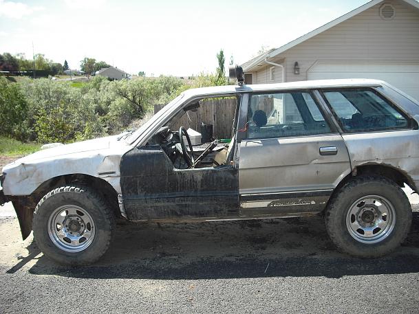

I'm sorry Ive been slacking.Here is a pic of my half doors.I forgot to add cupholders in the doors so I will have to make some when I get the chance.I modified the factory linkage for the doors.To open them,simply press down on the linkage.
EDIT: my engine is pulled so the radiator,overflow tank etc are sitting on the seats.
