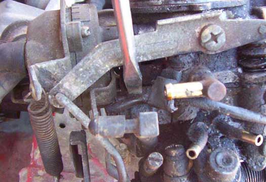

TROGDOR! Posted February 18, 2004 Share Posted February 18, 2004 Here's an update- I have the car for now as once I get it working right it'll be my ride to work (thanks James!). I got it to run! Sprayed some carb cleaner through it and played with the idle setting, and now it will start right up and run. However- the idle is very erratic, idling anywhere from 2000 to 3000 rpm. Below 2000 it will not idle, just sputters and dies. I tried driving it, and it runs fine above 2500rpm- anything lower and it runs either way too rich or way too lean- totally loses all power and dies, and when started again, runs so low that the tach doesn't register- with my foot to the floor. Then after 10 seconds or so it revs up and runs OK again. My bet is it's running lean as it wasn't acting like it was flooded- I never let it backfire (neighbors wouldn't like that at 8:30 AM) so I wasn't able to get the definitive answer. This was with that solenoid unplugged. Skip- the carb in your pic doesn't look too much like the one on James' car. According to the pics in the Haynes manual it looks like the EA81 Hitachi. Unfortunately this Haynes manual has no diagram of the EA82 carb- it jumps straight from EA81 to SPFI. I'm rather new to carburetors so I can't guess exactly what this solenoid is, but my guess- just from looking at the pics- is the ADS. The only difference I've seen between the old carb and the new is that the new one has 2 wires- a red and a black- going to this solenoid, where the old one only has a black. According to what I've read here, having the ADS unplugged would'nt seem to cause these problems I describe. Also, even when I was playing with the idle and had the car idling at 3000+ rpm, it never dieseled when I shut it down- not even once. Just shut itself off smoothly and quietly. This leads me to believe that this part is NOT the ADS. Any suggestions? I plan to swap all 3 wired parts later today if I can't figure anything else out. Here's a pic of the object in question. It is located forward and below of the choke. It's the object I'm touching with the screwdriver. Quote Link to comment Share on other sites More sharing options...
Skip Posted February 18, 2004 Share Posted February 18, 2004 it sure sounds like an ADS problem to me, although I can't make it out in your pict. The red wire no doubt goes to a hot when the key is on source (the choke is a good place) the black needs grounded. I sent you a couple extensive emails, please check them. and if you have time get back to me Quote Link to comment Share on other sites More sharing options...
All_talk Posted February 18, 2004 Share Posted February 18, 2004 I’m with Skip on this one, the function of the ADS is to close off the idle circuit when you turn off the key so that as the engine spins down it cant draw in fuel and run on. On most carbs the idle circuit effects the mixture up to about 3000RPM, I bet if you connect the ADS you low RPM problem will disappear. But I wouldn’t wire it to the choke, on my ’87 the choke only has power after the engine is running, you want the ADS open with the key on, the power wire for it is there in the 3-wire plug (car side), you just need to ground the other wire. Gary Quote Link to comment Share on other sites More sharing options...
Skip Posted February 18, 2004 Share Posted February 18, 2004 I agree with Gary, the choke is there and could be used as a test but.. why not use a test light on the connector from the body, find the proper battery feed. It has to be on that connector. Splice a spade connector on the red wire and plug it in. Ground the black wire. Quote Link to comment Share on other sites More sharing options...
