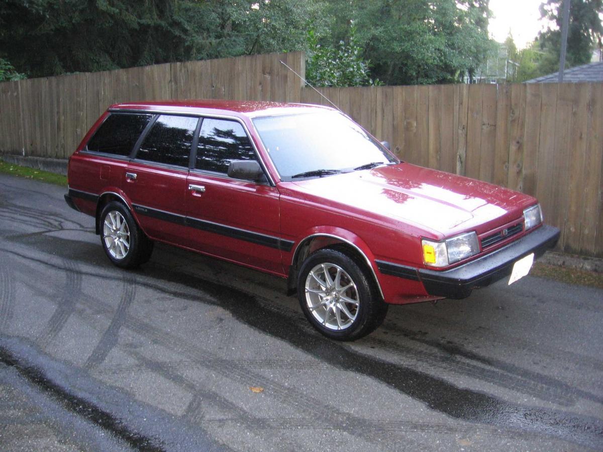

1983 GL with an EJ22 (This car had the EA81 that ate the cam)

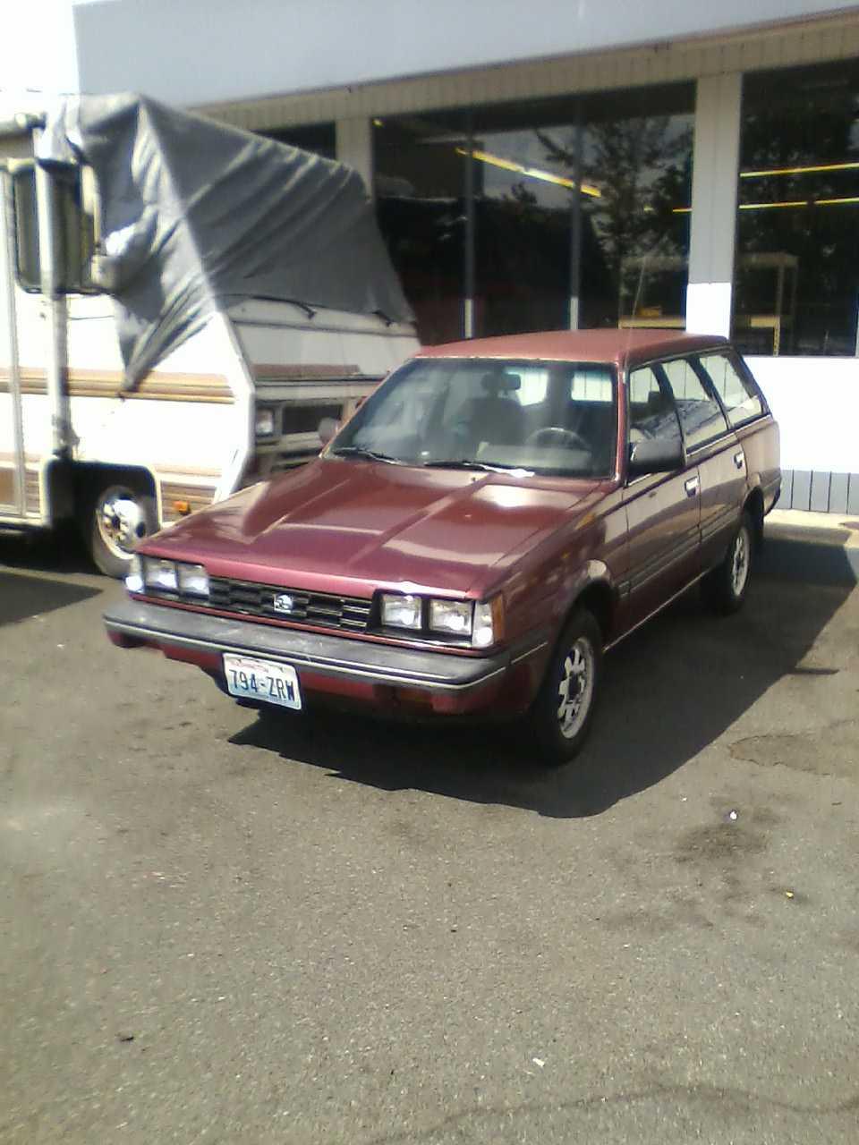

1992 Loyale also EJ22 (This car was WAY to slow with an EA82)

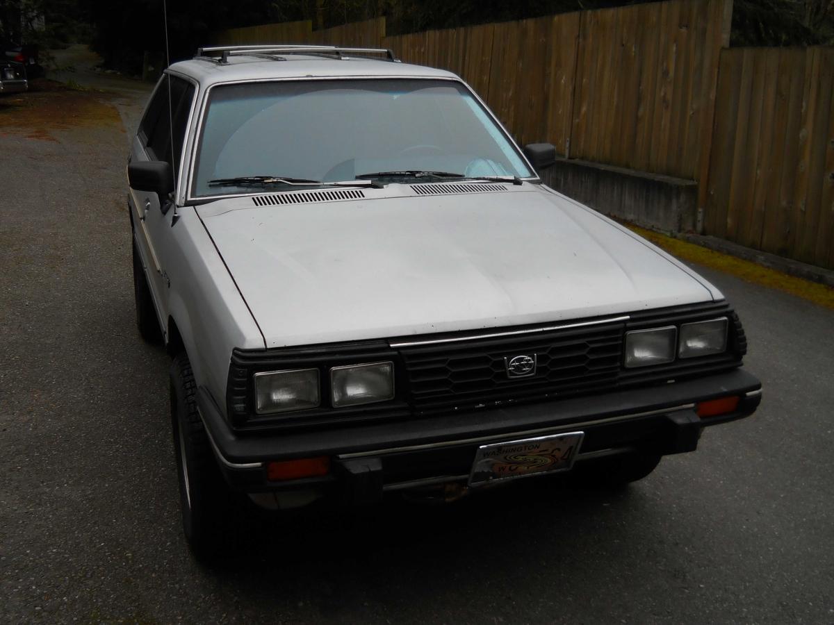

and a 1988 DL project that has done most of the mule work (and gets the best fuel mileage of all 3)
