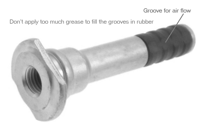

I had a similar issue to this and have come up with a solution I have not found mentioned elsewhere; Thought I would share, as it would have saved me a lot of time, pain and money had it been out there before;
The cause of the drag turned out to be over-lubrication of the calliper slide pin that has the anti-rattle rubber on it. The drag was so severe that I had smoke coming out of one front wheel from the burning hot rotor, which got so hot I seared 3 fingers touching it momentarily.
I had noticed, when I was rebuilding the calliper, that the slide pins were pretty dry so I added lube and a bit of silicone spray. This made them move very nicely, but I realised later that it allowed the one with the rubber on the shaft  to seal so it had trapped air below the pin that tends to force the pin back out of the hole.
The effect is that it puts a lot of pressure on the outer disk pad as it is forcing the mobile part of the calliper mounting away from the pin towards the centre of the car.
The solution is to clean all the lubricant, gunk etc out of the hole in the calliper then place a minimal amount of brake lube grease on the shaft. Check the anti-rattle rubber to make sure it has not swollen as this will cause the problem as it will seal in the bore of the calliper slide; You may need to get a new rubber if this has happened;
The rubber I had had 2 flat sections to allow air movement, but these were not evident on the old one, but I suspect that was swell from the grease and maybe the silicone.
I will be monitoring and may need to groove the shaft or the rubber to ensure it does not jam up.

some folks just remove and toss that sleeve away - some popular lubes are incompatible with that rubber and cause it to swell.

The cause of the drag turned out to be over-lubrication.....so I added lube......then place a minimal amount of brake lube grease.........was swell from the grease and maybe the silicone.
this misses the prevailing issue(s).
1. it's not "grease" and "lube" in the generic sense, that misses the issue entirely.  the issue is the *type* of grease, not amount or process.   old types of caliper grease will cause the rubber pin bushings to swell and seize in the caliper bore.
2.  Subaru's OEM grease is excellent or Sil Glyde or other high quality grease that won't impact the bushings. I haen't researched it but i presume it just needs to be silicone based?  I use it in all my Subarus even those without rubber bushings because it lasts so much longer.
3.  Or you can throw the pin bushings away and use whatever grease you want.  They're pointless and unnecessary, i've been doing it for years.
I do both, throw away the bushings and use better grease.
4. If you regrease the slide pins every tire rotation or two your brakes will last the life of the vehicle on basic pad and fluid changes.  you'll never need to replace rotors or calipers or have slide pin issues.
i usually also replace the caliper pad clips after 150-200k miles as they can get bent or built up or corroded over time and hang a pad, though they can be easily inspected to check for any build up or deformity that could cause issues.
