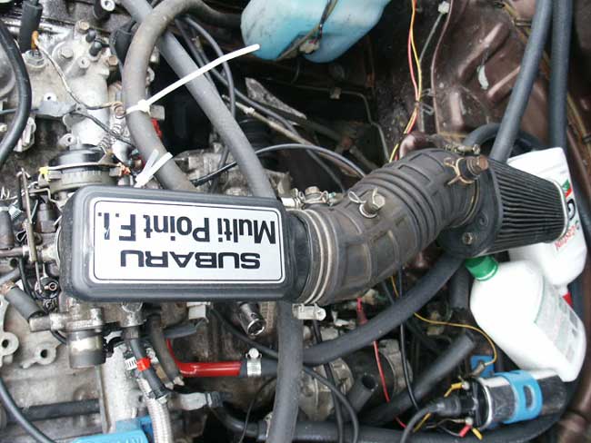

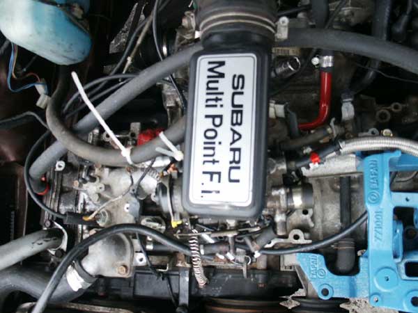

stephenw22 Posted February 25, 2004 Share Posted February 25, 2004 1986 Carbed EA-82 (Hitachi) What can I remove? (In other words, what needs to be there so the car will still run fine, and what is the unnecessary stuff?) UPDATE: I can see the carb now!!!!!!! This has probably been one of the most effective 'upgrades' I've ever done on a soob yet. It was tempting to take the intake off to really clean up the vacuum lines, but I can do that when it's a little warmer. I still need to redo the PVC system, kill the EGR, and get a better air cleaner, but that can also wait for another time. Quote Link to comment Share on other sites More sharing options...

archemitis Posted February 25, 2004 Share Posted February 25, 2004 just plug it all, except for the brake booster, and vac advance on the carb, and the in cab heater controlls. Quote Link to comment Share on other sites More sharing options...
subiemech85 Posted February 25, 2004 Share Posted February 25, 2004 disconnect EVERY line from carb EXCEPT FUEL RETRUN and SUPPLY disconnect EVERY line from intake manifold Except brake booster, dist advance, egr system, and air controller vac canister line remove emissions canister, egr valve, asv, pipes on heads block off or plug as needed you may also remove the vapor lines associated with the gas tank any more questions, ask away Quote Link to comment Share on other sites More sharing options...

84Scoobaroo Posted February 26, 2004 Share Posted February 26, 2004 archemitis - what did you use for an air filter on the end of that MPFI intake? Quote Link to comment Share on other sites More sharing options...
archemitis Posted February 26, 2004 Share Posted February 26, 2004 a filter from force products. they make those forward sweeping intakes for harleys and choppers, and i had a spare one off of my bike. its a k&n cone, knock off. it fits in the inside of the mpfi tube, i was gonna get a bigger cone, but im gonna ditch this motor saturday. Quote Link to comment Share on other sites More sharing options...
archemitis Posted February 26, 2004 Share Posted February 26, 2004 also, you can hack off the air suction valve pipes, and weld them up, along with your egr stuff. my pvc valve is plugged, and the hoses from the valve cover go to a remote filter. and you can take the intake manifold off and flip it over, to take all of the hard lines off, because you wont need any of them. lots more sanitary, than stock, cept for all my zip ties =] Quote Link to comment Share on other sites More sharing options...

84Scoobaroo Posted February 27, 2004 Share Posted February 27, 2004 I tried mounting the SPFI intake to the hitachi on my 83 and the carb didnt have enough "meat" sticking up for the clamp to get a hold on to. What did you do to extend the carb throat enough for the MPFI intake to clamp down on? The SPFI intake i got is just like the MPFI pictured. Quote Link to comment Share on other sites More sharing options...

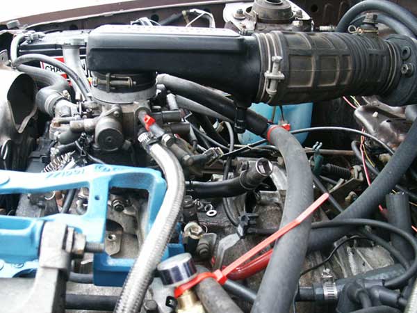

The Scooby Posted February 27, 2004 Share Posted February 27, 2004 if you look in his second picture it looks as if he used a peice of pipe to extend it up. Quote Link to comment Share on other sites More sharing options...
archemitis Posted February 27, 2004 Share Posted February 27, 2004 i thought the same at first. once you clamp it on, it just pops off the top. i took a file and put some grip points all around the spigot parf of the carb, so bacicaly theres a lttle trench runing around the carb, for the rubber to bite into. also, i think the spfi is different sized. the mpfi has a rubber hose that connects it to the carb, and i cut that down about a half inch so my hood would close. this is all in an ea81 hatch, so that might be why i had the hood clelarance issues. and maybe the hood holds it on kinda, but it does take alot of force to hold that thing on there. you can hear the intake from the cab real well now. Quote Link to comment Share on other sites More sharing options...
stephenw22 Posted February 29, 2004 Author Share Posted February 29, 2004 I can see the carb now!!!!!!! This has probably been one of the most effective 'upgrades' I've ever done on a soob yet. It was tempting to take the intake off to really clean up the vacuum lines, but I can do that when it's a little warmer. I still need to redo the PVC system, kill the EGR, and get a better air cleaner, but that can also wait for another time. Quote Link to comment Share on other sites More sharing options...
