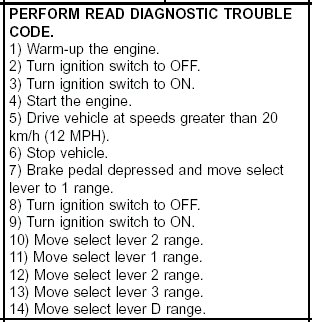

Well... finally found the proceedure to pull th TCU code on my 99.... there is no connector in the #5 slot of the fabled 6 pin connector..... so you have to do the Tranny Code Dance.... Got the code of 45. Anyone know what that is, or where I can find it?
Thanks!
Mike
BTW.... I'm going to try to attach the dance card for the tranny code dance....

So I've found that TCU Code 45 is "Intake Maniford Pressure".... does this clue me into what has been causing the problems? Does it fit the symptoms?
Thanks,
Mike

As you found, TCU code 45 relates to the intake manifold pressure signal (the "baro", which I mentioned previously), and indicates an open or short in the circuit. This can be "real", or due to a problem in the TCU itself. The first thing to do is check the ECU for codes, even if the CEL isn't lit. Specifically, P0106/7/8 might show up.
As you brought up before, it could be that there's a swap-related connection problem, but let's hold off on that until you see if the ECU is storing any codes.
