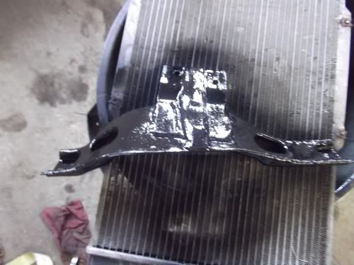

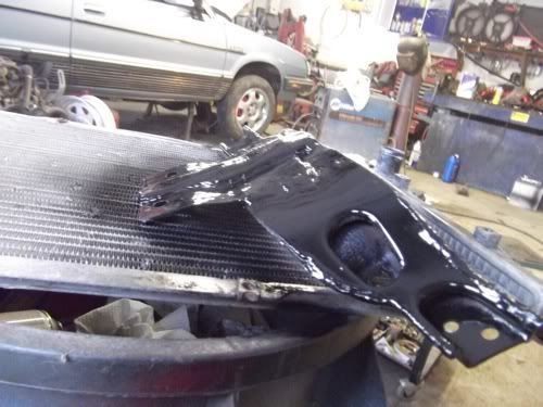

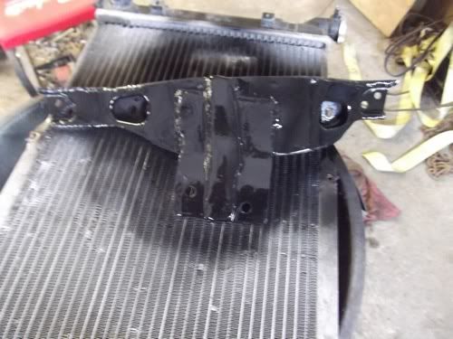

I just got done welding and painting it so here are some shots of the new brat/ej trans mount
Posted Image
Posted Image
Posted Image
Posted Image
I'll add some more after the paint dries and it's in
