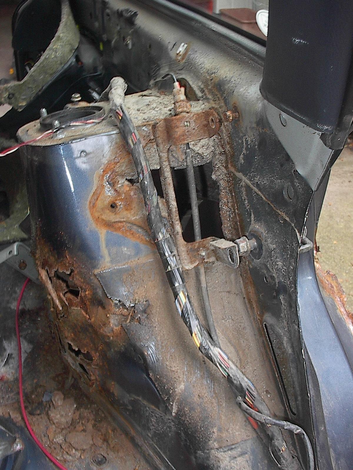

Bonomo Posted June 27, 2013 Share Posted June 27, 2013 I have a 1993 Subaru Legacy LS Wagon. A mechanic who was going to work on a problem with the power steering pump noticed a bad left rear strut and an exposed wire harness in the wheel well. After replacing the rear struts, I pulled out the inside rear trim to prepare for welding. Oy. (BTW, does anyone know what the tube is hanging over the top of the strut tower that looks a bit like a Pitot tube?) Quote Link to comment Share on other sites More sharing options...
heartless Posted June 27, 2013 Share Posted June 27, 2013 (edited) Bonomo - 93 LS wagon? I am betting that the car used to have air struts, and that is the air line that used to feed that strut (I have a 90 LS wagon that I pulled the air struts out of) that short black bit at the top is plastic tubing that got cut off, right? if it is, then yes, that is the old air system for the air struts. you can safely remove that whole section if you want to. Edited June 27, 2013 by heartless Quote Link to comment Share on other sites More sharing options...
