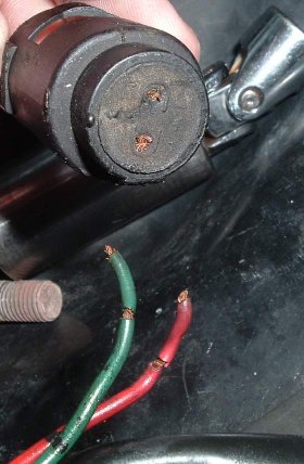

WJM Posted February 29, 2004 Share Posted February 29, 2004 Pic speaks for its self! So i pulled out the entire disty wiring harness to fix it... Quote Link to comment Share on other sites More sharing options...
junkyardgabe Posted February 29, 2004 Share Posted February 29, 2004 eeeeeeewwwwwwwww! that's not good !whats a rat live under there? Quote Link to comment Share on other sites More sharing options...
asavage Posted February 29, 2004 Share Posted February 29, 2004 No joke, we've had several Ford products come through in the last year with the injector harness looking just like that. Something about the insulation in those wires that the rodents like. We also gets lots of cars that have rodent nests in the air filter housing. If I'm not mistaken, that's the knock sensor connector, right? Quote Link to comment Share on other sites More sharing options...
WJM Posted February 29, 2004 Author Share Posted February 29, 2004 Sho'nuff. Knock sensor connector. And nope, no rats or anything like that underhood. Just heat. Heat is what killed the insulation on these wires...that and they are about 18 years old come March. Anyhow, Ive patched things up, the wiring harness is sitting beside the puter on a work table...too tired to install it. Plus, gotta change tires and install another (quieter) exh before a running test is started...oh, and unfoul plug #2...its all oiled up. Quote Link to comment Share on other sites More sharing options...
WJM Posted February 29, 2004 Author Share Posted February 29, 2004 Well, ive fixed it. But now I have picked up a permanit miss on cyl #1. Getting spark and fuel.....maybe it just gave up. Quote Link to comment Share on other sites More sharing options...
