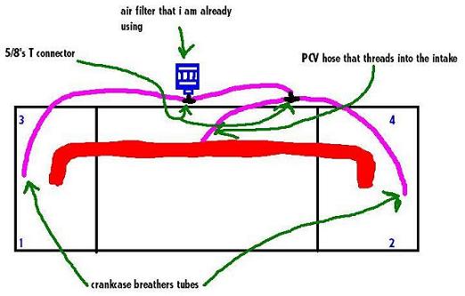

so what, run one hose from, lets say driver side valve cover, the valve cover into the intake where that fitting is that screws into the intake. then just use that filter i just picked up on the passenger side valve cover??
can someone draw me a picture in paint or soemthing, im a total retard.

Here's a very rudimentary sketch of how to keep your PCV system intact while removing everything else. It's been working marvelously on mine for over 6,000 miles.
Posted Image

see something like this, wouldn't this work??

That's basically the same thing. The only thing I'm not sure about is exactly what that little fitting is that the drivers side line goes to in the stock setup. I would guess some sort of regulator that lets filtered air in under certain conditions but not others. I'll try to look at mine tomorrow and see what it does.

who gives a dam, im 17 and cant draw worth crap but i can fabricate anything.
anyways, because the PCV hose is constant vacume it is close to the driver side vent so it would pull more from that then it would pull in clean air, then the passenger sice would be mainly clean air.
because of the difference of tube length.

The idea is that air will enter one valve cover, flow through the crankcase, and exit the opposite valve cover, go up the hose, through the PCV valve, and into the intake, where it gets burned.
As the air passes through the crankcase, it picks up the fumes from the oil and the gas which has blown past the rings, as well as any candensation that might have accumulated in the pan. This helps keep the oil from getting diluted as fast, as well as burns up these vapors, instead of venting them to the atmosphere.
So, in your drawing, remove both of your T's, put your little air filter directly on the passenger side valve cover, and run a hose from the driver's side valve cover directly to the PCV valve. PCV valve looks like an ordinary metal hose barb, sticking out of the intake manifold.
This is basically the same route as the factory system, although some Subs have a "Secondary air filter" or other junk somehow involved...

redlance, thanks a bunch for clearing that up, it makes sence now. ok so i just have to put my filter on one side and hook the other to the PCV barb on the back of the intake.
