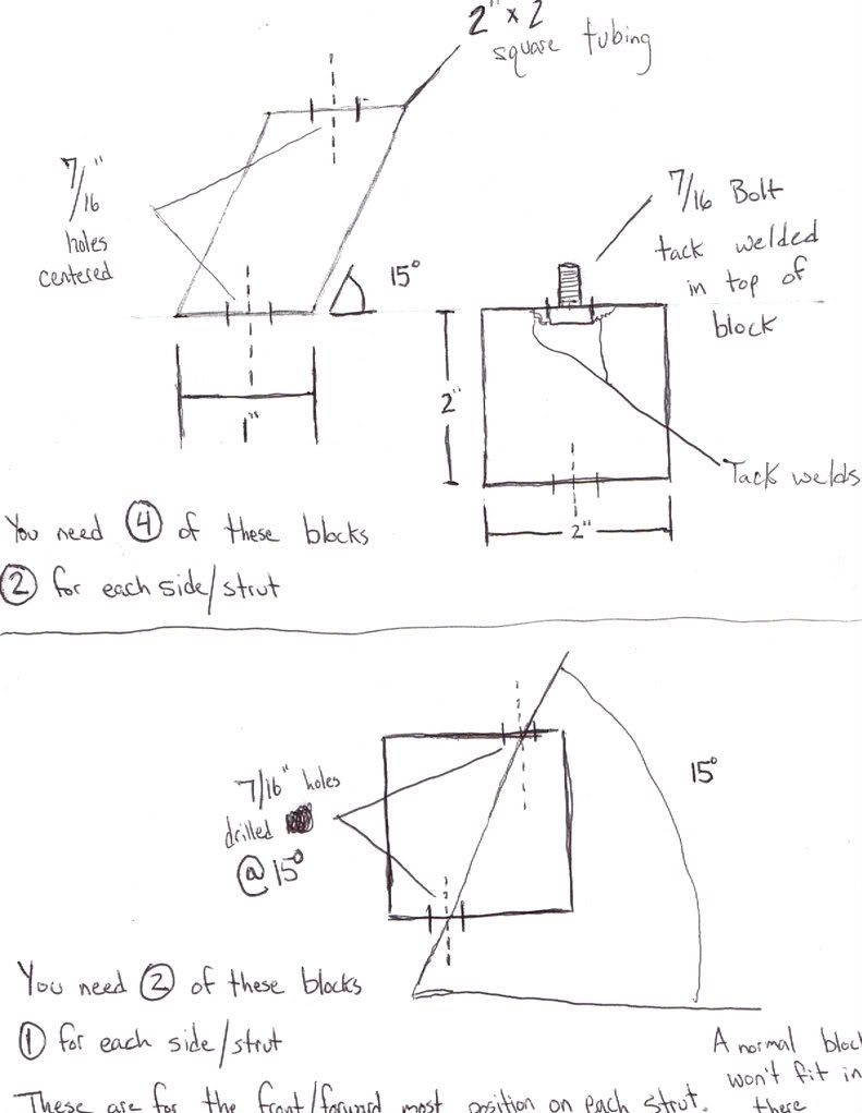

this is a square steel tubing lift?
looks good :clap:
#30 one eye
one eye
    I'm A Subaholic
  • 2,593 posts
  • Mt.Vernon Washington
Posted 01 December 2011 - 12:07 AM
looks good :clap:
yep its one of these ones..............

Thats exactly right Ghost, you do just slide right into the seat. Whats also nice about the 2" lift is that it keeps your rear diff tucked up and out of the way.
so is your 2 or 4" eitherway im trying to compile a material list to perform the lift. tires and prefabed wheel will already be waiting.
#33 one eye
one eye
    I'm A Subaholic
  • 2,593 posts
Posted 02 December 2011 - 12:02 AM
6 blocks that are cut with the 15* and 2 2" round blocks to lift the rear, cut the eye off the bottom of the strut and weld it in good to go, then get a set of 27's ............... all done

Yeah exactly what Jeff said. Now that i look back on it its super easy, i could have and should have done it a long time ago. Just get some wheels and tires and lift it and be done.

there's no lowering of the crossmember?
everyone thinks im crazy for even contemplating this here in michigan.
these old subarus are a rarity here.
if theres anyone in the west michigan area who would like to help it would be appreciated and compensated for!
IF I STICK TO 14'S THINK I COULD GET AWAY WITH THE STOCK ADJUSTMENTS?
#36 Vegablade
Vegablade
    Eat, Live, Breath Subaru
  • 548 posts
  • Concrete WA
Posted 09 December 2011 - 12:16 AM
No crossmember dropping. My front struts were dropped 2 inches, and extended the rear struts 2 inches. Removed the front sway bar. Added big tires, thats about all.
14's? Depends on the tire size, mine are 27" you could get that size stock but you would have to bash/cut the crap out of your car.
Follow the instructions that one eye made and you will be set.
