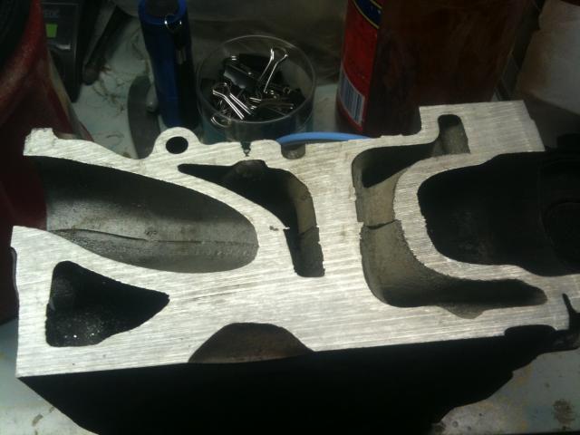

Here is a thread I did a while ago, may help you with your modifactions...
http://www.ausubaru....ead.php?t=15810
I reckon the way to go would be to make an adapter for the bottom, with a splitter that extends up to the port divider and converts the 2" port to 2x 1.5" in the EJ pattern (as you mentioned). Unfortunately each heads divider casting seems to be unique (I have cut, drilled, chopped, opened about 7 EA82T heads) so the splitters would have to be individually fitted and gasket thickness allowed for.
Another option, which I also considered, is to cut a piece of 4mm Aluminium, fit it to the port divider and tack it in place with the tig at the flange face.
I considered doing this, as I just finished making some headers, but I decided to stay with single 2" pipes this time.
BTW, let me know how much you want for the heads, always looking for good ones, especially G3 ones...

Brilliant. Thanks for the pics. I have done 2 sets of EA82 heads (one MPFI one SPFI) and extensively worked the exhaust bowl/guide area. Interesting to see just how much it chokes things off! Shame you didn't get a cut showing the short turn radius of the exhaust port, but that's good stuff.
With the 4 mm aluminum plate idea, I had that also. With the right torch, you could weld the whole thing in. With no cooling jacket I'm not sure how it would hold up over time tho. But with a D and reverse D at the flange (a bisected O) you could take two exhaust pipes of the right diameter, hammer the adjacent sides flat, and weld them into an EA82 flange. This'd give you a nice smooth transition in shape from the D to the O in the primaries without too much complication. Alternately, you could bisect a section of pipe with a bandsaw and weld a thin piece of plate in there to get the bisection ... then neck it down to say a 1.5" secondary where your bisection ends. Would be equivalent of a really short primary, but still worlds better.
Thanks again for the pics!

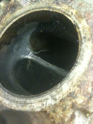

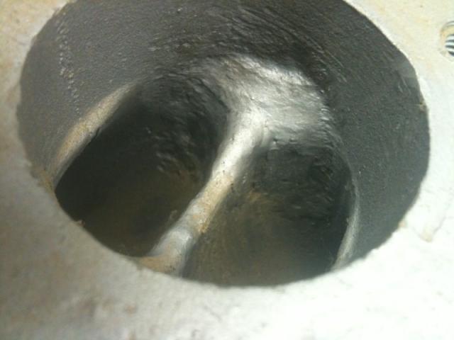

Im up to 4 heads now, The rest are on motors I cant get too yet.
3rights and one left. The L is in good shape, 1 caracked, 1 cracked and repaired and 1 uncracked.
I scratched at the crack abit to make it more visible. the repaired head looks like an epoxy type product?
