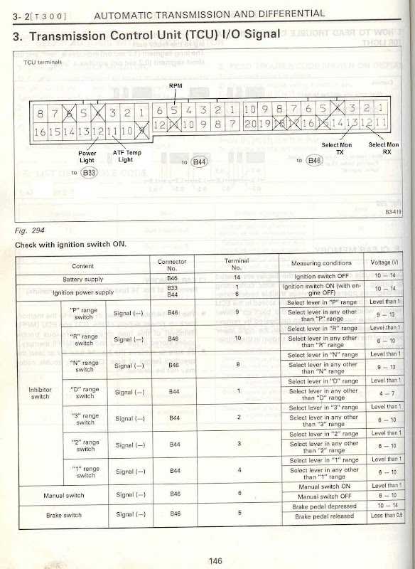

Lucky for you I had this EXACT same problem, and I fixed it. The TCU is bad. I would swap out the TCU. I traced all the wiring back, and even dropped the trans pan and replaced the solenoid, and I was having the same problem. So I replaced the TCU, and the problem went away.
Now if you want to just override it, that's easy as well. Find the wire (Connector B33, Pin 5 in the diagrams below) and apply 12+ going to the solenoid. I would of course wire up a relay and a switch, but that should be all you have to do. The solenoid will lockup when it gets 12v+. I don't recommend doing it as it will probably fry the solenoid at some point and make sure you fuse everything properly, but if you don't care about any of that, then have at'er batter! There's my disclaimer.
These pics are of a older legacy TCU, but the wires haven't changed, and these pics were handy. I actually have the complete FSM for a 1995 legacy on my computer, but I really don't want to look for it, so there pics will do. The wires are the same either way.
Personally what I would do is test the resistance of the circuit itself and see if there is a short in the circuit, or if the solenoid actually still works before I would go cutting wires. If you need help with diagnosing your Duty B solenoid, then just ask!
