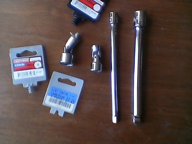

Got "defeated" trying to change out a knock sensor last night. The angle wasa okay to remove it, but trying to start the bolt back kind of bugarred the thread.
I did have a set of 3/8 drive swivel 6pt socket but something a little smaller would have probably got it from the start.
So, i picked up these today i needed this.
Posted Image
1/4 inch drive swivels, 12mm and 14mm 6pt Crafstman
3/8 wobble extension
1/4 drive long extension
I got beat last night on it, now i will maybe have better lucks.
