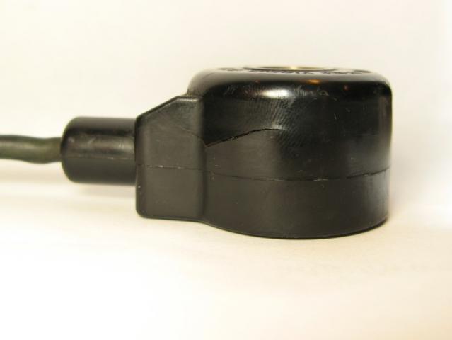

One more point to the statistics:
'99 OBW running a '95 EJ22 out of an Impreza with no codes related to the knock sensor, but running like crap. SERIOUSLY underpowered at low RPMS (bad enough you may consider turning off the A/C if you need to join the interstate). After 2500 RPM the car has somewhat decent acceleration.
The knock sensor looked fine but after removing it I found it had a crack on it's side (see picture). It may be a placebo effect, but it *looks* like I may have gained a few HP after replacing the knock sensor with a Beck Arnley unit

also, I know from experience that if the knock sensor goes bad to where it doesn't read knock but carries the right resistance, that the computer will advance the timing, hunting for it's limit with fuel given and ping like hell. My 90 did that until I replaced it. I lost a few horse and gained some fuel mileage.
