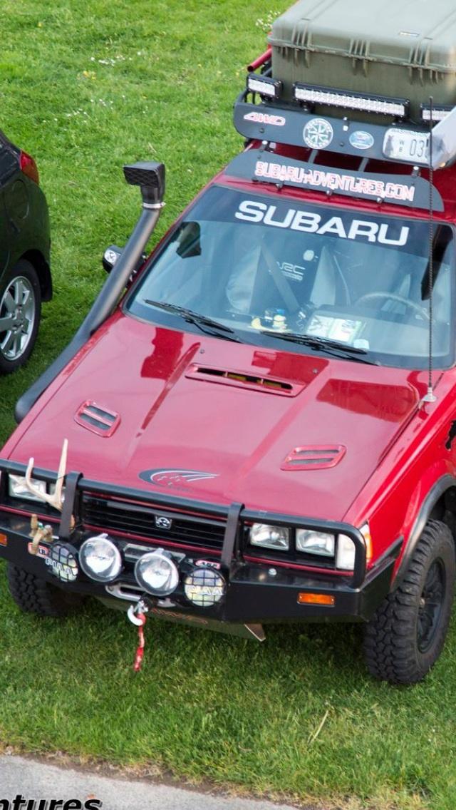

Also, a mate shared a pic with me of a vehicle that looks a lot like your Loyale:
Attached File  image.jpg   126.11K   19 downloads
^ yours? I'll need to show you how to mod the snorkel so it sits flush on the A pillar ;)
The reason why this pic caught my attention was a) it looks a lot like your Loyale and B) if it is your Loyale I didn't know you had the bonnet scoop and rear facing wrx style vents - when did these happen?

Bennie mate! Long time indeed.
Yeah I am taking my time with the panels and such, along with reconstructing and improving the rear frame rails/bumper mount. I'll need to re-fab the entire rear crash box to make it durable and ridged enough to pull the car out and handle a spare tire on the bumper. I have also been messing around with the Hardtop, making a Rallye' bar with lights.
As for the L-series, it does look a lot like mine. In fact I know whose car it is, It belongs to Brain Dudas, he takes the car on Overland adventures and such. We have talked a lot about suspension setups. https://www.facebook...aruman5?fref=ts
As for the Snorkel, mine does sit flush with the A-pillar. The Sand and Heat gun trick worked perfect!
