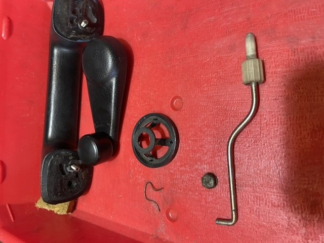

I've removed many 100's of handles on all assorted cars. They all have a "c" clip on the backside you need to grab it from the back side and slide it off.
