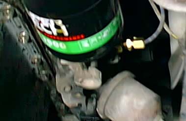

there is a 5/16 square head pipe plug in front of the oil pump, above the guage sending unit, remove and thread in the necessary adapter
you need more than the standard length of tubing if you don't want the guage by the hood
