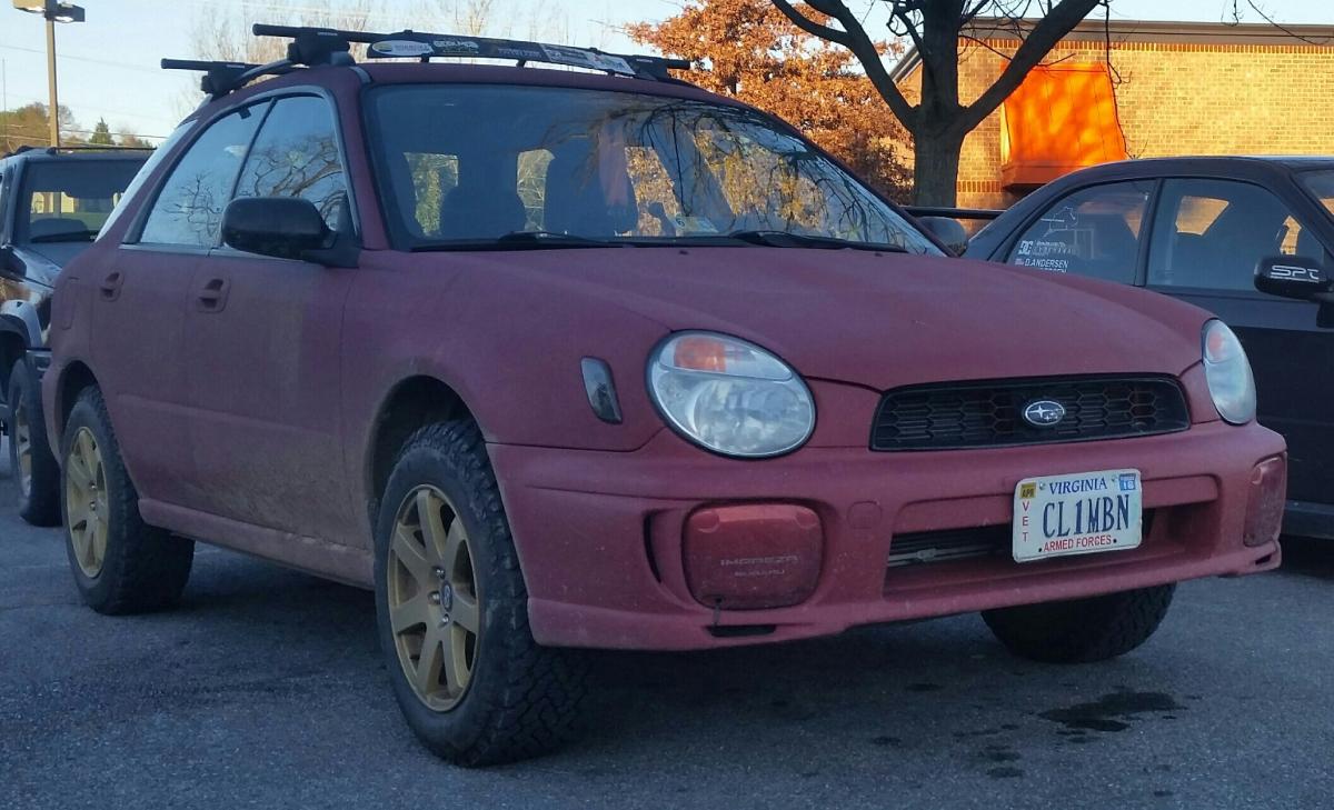

QualityAutoPB Posted February 5, 2016 Share Posted February 5, 2016 How do you attach pictures so they're not the tiny thumbnail? Is it because I'm doing this on my phone. I'm getting whooped and I'm usually pretty text savvy. Attached is a better view of my stance 2 Quote Link to comment Share on other sites More sharing options...
