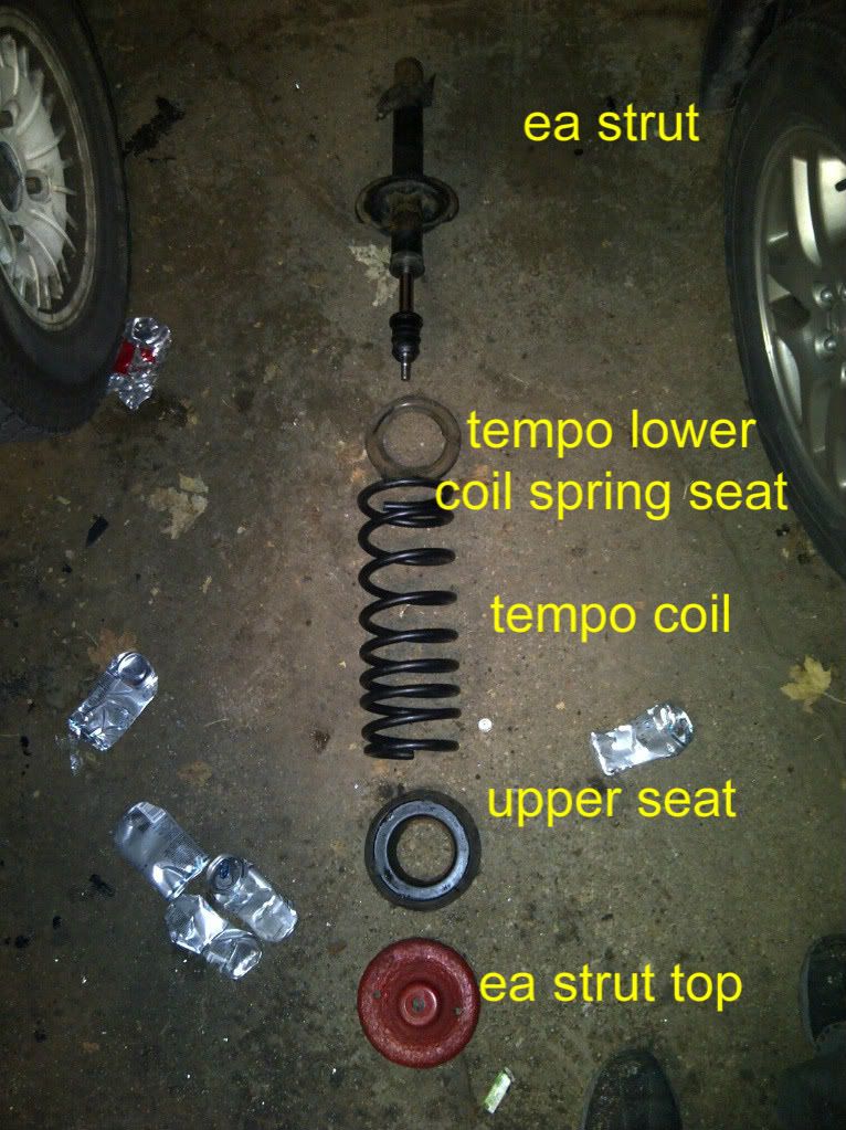

ok, so i put the spring on the strut and here's what i come up with as far as alingment of this spring.
Posted Image
Posted Image
Posted Image
i didnt line up the top part yet. but thats ok for that much space on the side opposite of the coil stopper thing? (thats the technical term:burnout:)

$30 later i have a strut assembly from a 91 topaz. i didnt realize it at first, but the spring was broken about 2" from the end. anyways. i popped it apart and got the parts i wanted... the spring seats...
Posted Image
i think this is going to work now with the springs i have. the only thing is i dont know how much spring to cut off since these are variable rate springs. i'll probably have to put one of the ea setups back together. do some comparisons between the new and old and weighted and unweighted setups. the spring seats make this all look better to me.
regardless. that sounds like its going to suck. since my car is already lifted 2" and is a *************** to get apart to begin with.

i cut 3 coils off and mounted the spring. theres enough tension in there that i think i might have to cut another 1/2 to 1 coil out of it, i put some pressure down on the assemblly as is. like 200lb man pressure and it didnt budget one bit. i think i have the top part on 180 dgrees outta whack too?
Posted Image
Posted Image
man i wish i had a hydraulic spring compressor. LOL

I still Wonder why my Tempo Coil Springs were Not too Hard to install, They fitted right there without any cut and the car has Suspension Travel.
I don't have Hydraulic Compressor neither... So there's Something wrong here.
Maybe you were Right with your idea about the Salesman that might Gave me the Rear Coil Springs from the Tempo and told me those were from the Front...
Or maybe the ones I obtained came from the First Gen Tempo; I have not enough information to Properly answer that, as I explained before.
Really I Don't Like How your install looks now, the Springs Looks very much Forced.
Let me Tell you that I installed the Tempo Springs on my Heavy Weighted 2.7 (ER27 engined) Wagon using Rubber Donuts!!! :eek:
Of course, I Removed the Rubber Donuts when I installed them on my Weberized EA82 Wagon.
So Definitely I don't believe that you Got the Same Tempo Springs that I Obtained.

well. going by wikipedia, the first gen tempo ranged from 83/4 up to 88, i have in my posession now, in non returnable form, a strut assembly from a 86 tempo. as well as a 91 mercury Topaz. both are identical. also there was no V6 tempo introduced until like 1992 (accordin to wikipedia, which is my only reference)
the springs you see in my pic may look different as they are/were variable spring rate springs and i basically cut of the top 3.25 coils to give it a chance to fit in the ea82 strut.
also, i adjusted them, rotated the tophat, and they look more like they are supposed to now. they dont fill the diameter of the ea82 strut all the way, because they are not as narrow.
the thing about the rear TEMPO struts is that the spring rate is only like 115, 20 less than the stock ea82, so, any gained stiff ness would be from compressing the spring into the strut because its less compressed to begin with and then not uncompressing all the way when installed (if that makes ANY sense) but you are still compressing it
is THIS more what your spring looked like?
Posted Image
This would be the rear spring. spring rate 115, height is 15" (About 3" taller than the stock ea82 spring, but much easier to compress for fitment) stat says it has a install height of 10". it also looks to be almost conical on the bottom, so that part would feed down into the strut
the stock ea82 spring i have on my table is slighly over 4.5" ID and 5.5" OD, 12 9/16" tall. installed height is about 9.5" roughly.
SO that being said. im glad i wasted $60 on some ************ty front strut assemblies from a tempo/topaz, $65 on new replacement springs which i cant return because i chopped one up, 6-8 hours of my time driving around, cutting, assembling, dissassembling, reassembling something that most likely isnt going to work.
and another undetermined amount of time if i go and try to dissassemble some struts in a pick n pull by hand (i can use my air ratchet to turn down the spring compressors at home) or blow $70 on a new pair.
christ, all i want is for my damn front end to sit freakin' level.
Edited by xbeerd, 02 November 2011 - 08:45 PM.
