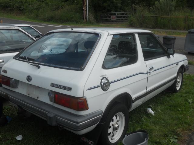

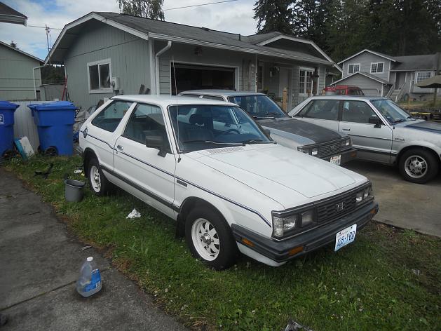

First of all we need to know if this is an EA81 (a *true* hatch) or an EA82 (technically called the "three-door coupe")? Pictures would be best.....
GD

Its an ea81. Just like my 83 wagon was. And i would love to post pics but i don't know how to using ones from the computer :/

Posted 14 July 2011 - 02:32 PM
i hope this works

Posted 14 July 2011 - 02:35 PM
Aha we have Photos!

Posted 14 July 2011 - 04:03 PM
Ok - unless it's a CA model it will not have an ECU. It's a carb - plain and simple and gutless. It will be a Hitachi DCP-306-XXX variant (26/30mm primary venturi's). Best replaced with a Weber 32/36 or converted to Fuel Injection using the SPFI system from the '87+ EA82's (and some '86 2WD's).
Sounds like the idle speed may need to be adjusted. There's a screw for this on the Hitachi - it's on the throttle cable side - look and you will find it. It's a long one with a spring under it.
