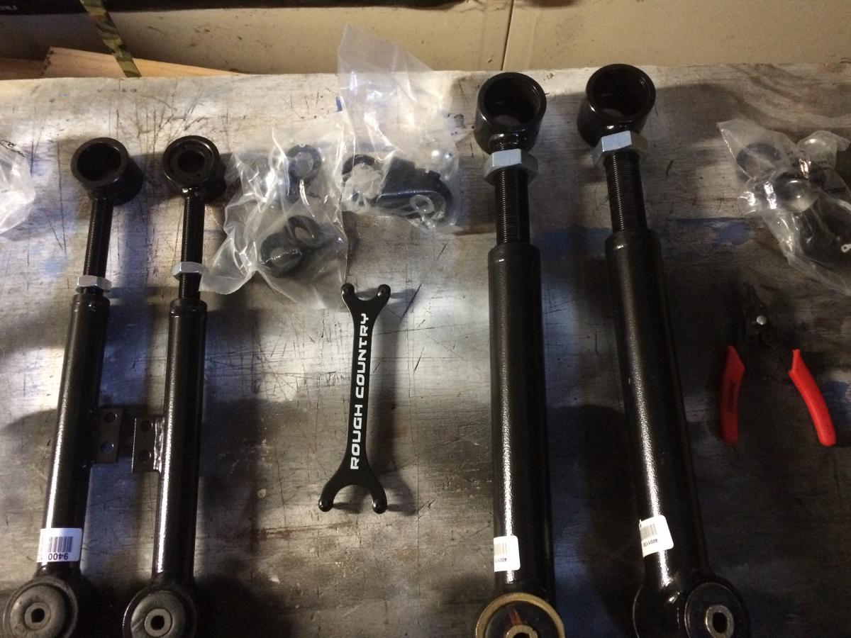

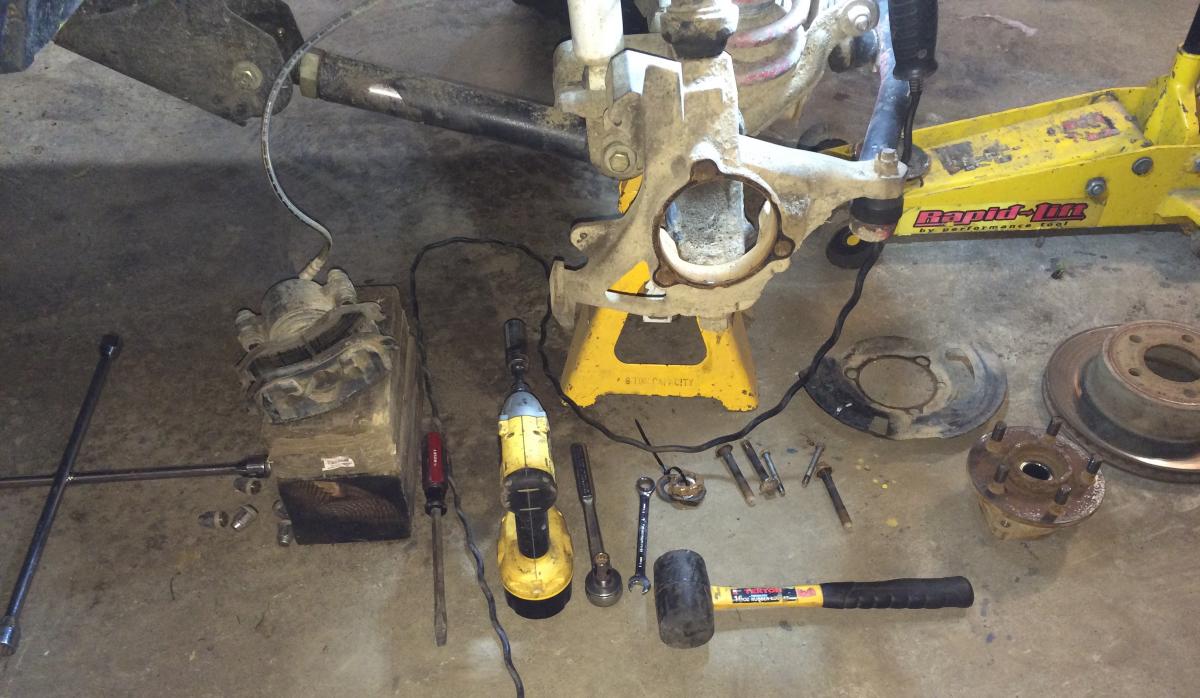

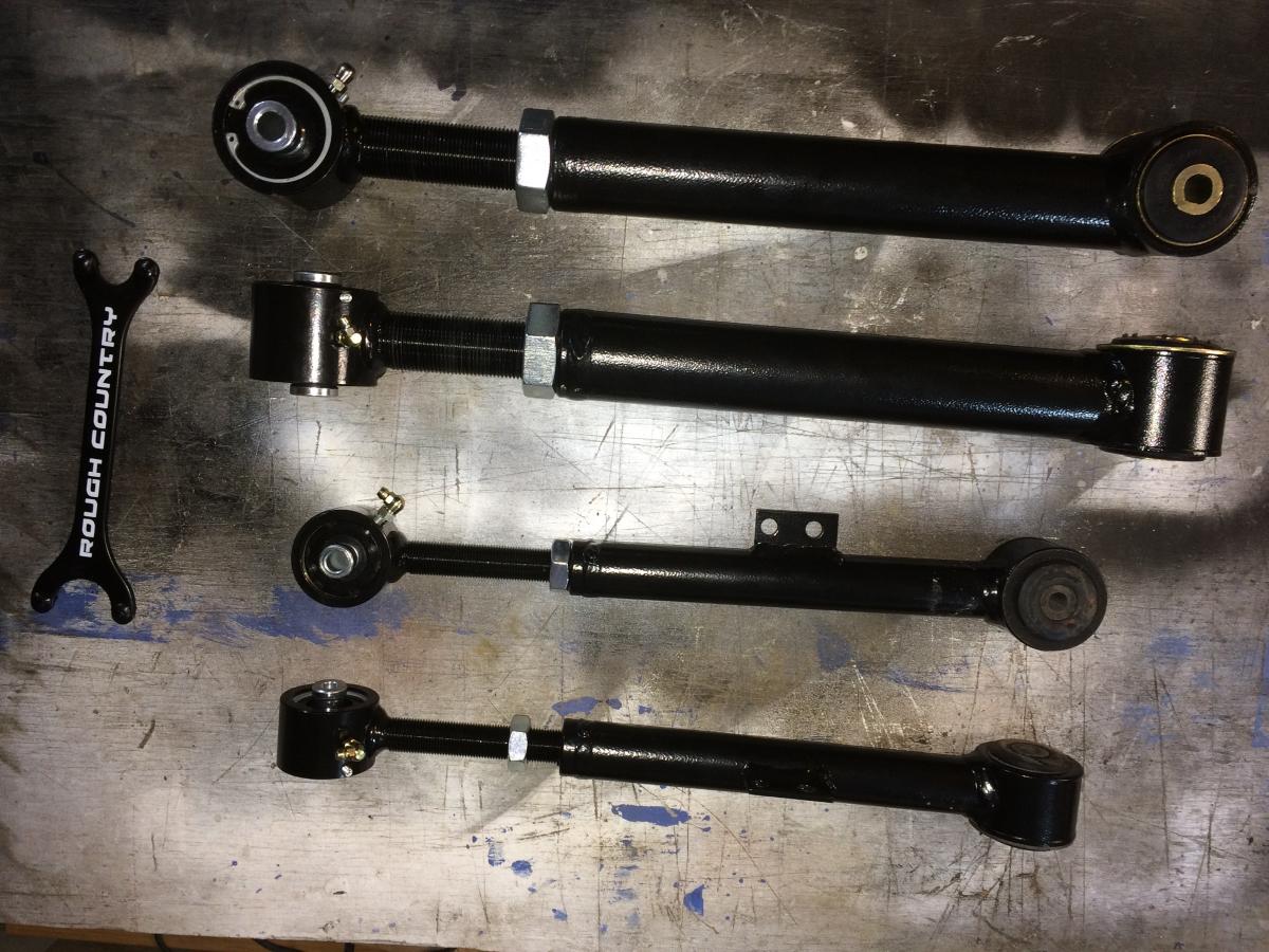

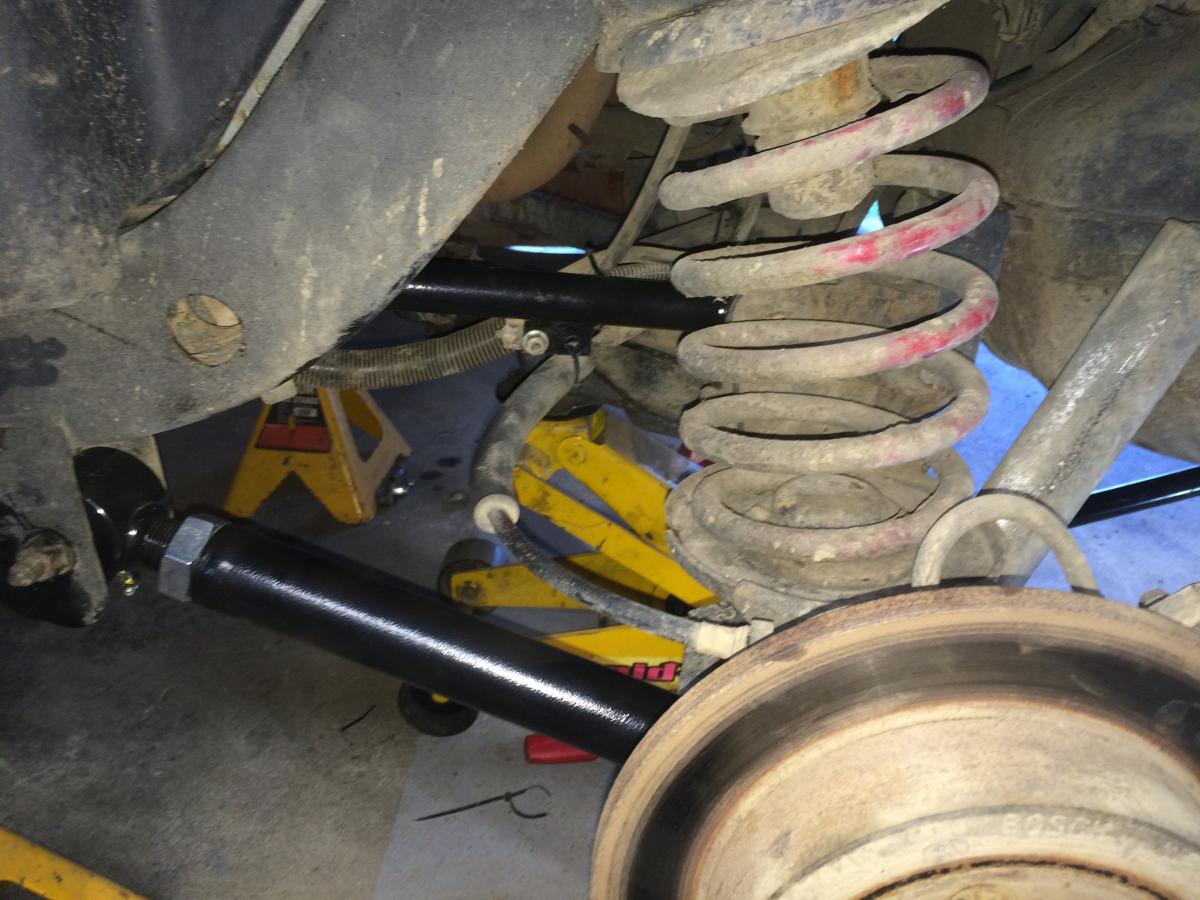

I had an extra 3 0r 4 hun laying around that I figured I'd throw at Butch.  I KNOW I need shocks, the bushings are cracked and toast.  But I also wanted adjustable rear control arms so I could angle the pinion up a little so I could get rid of the spacers lowering the transfer case.
So I decided to do the arms first.   It turned out to be pretty cut and dry, a pretty simple swap as far as things go.
Attached File  IMG_0172.JPG   171.64K   16 downloads  Attached File  IMG_0169.JPG   137.17K   22 downloads
It turns out, I chose correctly.  I was > < so close to some serious carnage.   Get a load of the busted upper control arm from the passenger side.

The lower arms look pretty stout, but the uppers not so much…..
#41 ezapar
ezapar
    [OTD]
  • Moderator
  • 27,377 posts
  • Seattle
Posted 19 October 2015 - 11:26 AM
The bushings were all shot, 110k and 11 years of being in there.  The guy before me clearly wheeled it a lot.  I've put a ton of off road miles on it, I know they've taken a serious beating.
The uppers are indeed thinner.  But they won't rub against rocks or anything like that. Compared to the stock arms, they're pretty beefy.  Plus, they are screwed all the way in pretty much.  They're adjustable enough to be also used on the LJ.  I have confidence.
It rides so much better now, all the clunks and bangs over bumps are gone.  I still have to replace the front uppers with new ones to iron out the last of the bad bushings.  Then the shocks and it should ride like new.

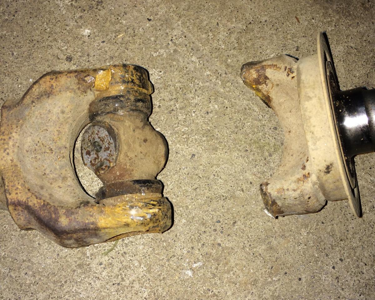

I took it up to Snoqualmie with my brother and my old Toyota to play in the snow.  Found a couple of feet of snow at the top of the hill.  We made a little fire and had a good time for a bit.  I tried some crazy stuff and broke a front axle.  Had to do the walk of shame and pull out my winch while trudging through feet of snow in front of the guy who'd showed up in his Big ol' Toyota.  Then I had to nurse it down the hill at about 4 mile per hour for about an hour to get it to get towed.  I didn't have any tools, and there was no chance of getting a replacement axle on Saturday night.  So I had to do the ride of shame too.

I guess it was about time for that axle to go, it looks pretty haggard and rusty.  The U joint is probably what failed first.

But there are bright sides to the story.  I was so happy I wasn't half way up Evans Creek somewhere when it blew.  It was all down hill to get back to the highway.   It turns out I have a Dana 44 in the front too.  hey.  Here I was thinking I had a 30.  hehe.  And the biggest blessing is just how easy it is to change out an axle.  Far easier than any Subaru axle I've ever done.  And I've done a TON of them.

Yeah that knuckle joint looks toasted. Are you replacing with an OEM axle shaft?! Orrrrrr UPGRAYYYYYDE!!

I wish.  370 bucks for plain old Yukons each, on up to 1200 bucks a side. . .  I went cheap, 200 bucks for OEM.  It should be fine.  If I would have changed out the u joint, I probably would be fine still.
