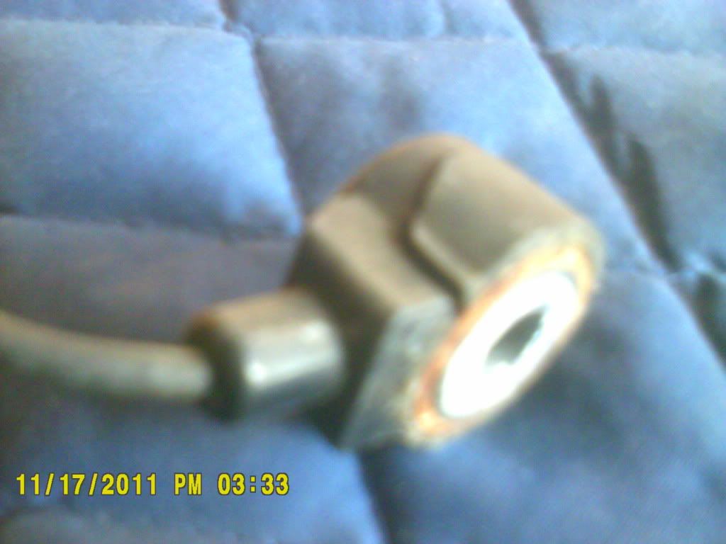

Posted 17 November 2011 - 03:35 PM
Posted Image old knock sensor was toastit was still one with the grey connector, so original too the car.
Posted Imagetop cracked too
new knock sensor today
last week new air filter.
replaced the autozone plug wires with some used but newer NGK wires from a junkyard car.
going to try and get the gas guage working this weekend with some parts from ShawnW.
PS. I have a stash of like 12 of these cracked KS's. Every single legacy i have owned has had cracked ones, and the several engines i have pulled at junkyards too are cracked.

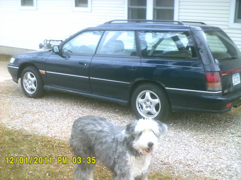

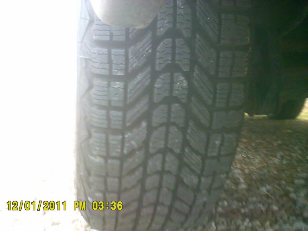

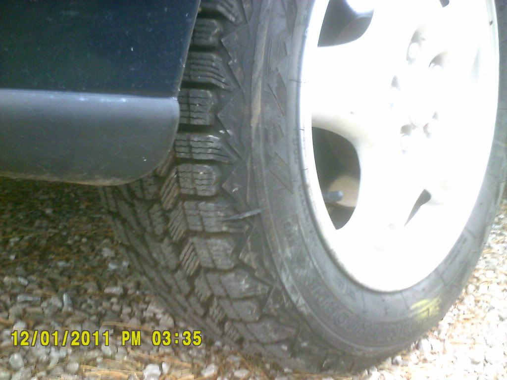

removed the stock wheels.
Recently I got a set of 4 Winterforce snows on craigs for 100 bucks. Yesterday I had my friend mount them on my spare 94SS wheels from Mick's car. :)
Posted Image
Posted Image
Posted Image
Posted Image
Now, I hope it snows soon.
