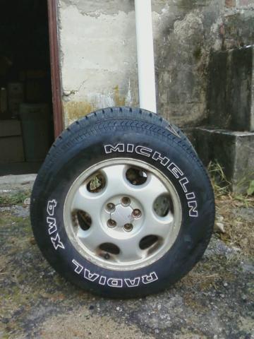

I'd like to have at least the swap done before May (spring Vermonster event),doubt i'll have the bigger tires (was hoping for 215/75/15s if they'll fit with just the strut lift)
(size i want is in attached comparison pic,gonna swap free tire to stock alloy and use for test fitting)

i know going 215/75/15 (27.7") isn't much of a gain over stock size of 205/70/15 (26.3") but it'll be a start of gaining some height.
It'll be about 1.4" gain (providing my math was correct)
