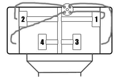

Plug firing order on 83 brat
Nice picture :-\
The answer to your question is 1, 3, 2, 4.
If you follow the wire back from #1 cyl in the drawing you'll see where the rotor will need to point.
