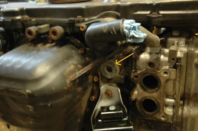

They both have the same size threads. The only diff in the oem kits is the wiring. I was in the middle of replacing my thermostat when i pulled my plug. From what i have read (and there is a very good write up on scoobymods about this job with pics) very little coolant comes out if you choose not to drain the system. I would be careful about air pockets however, attached is a pic of the plug that needs to be removed.
