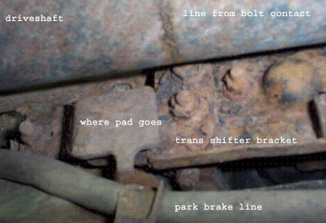

Fuji Fellow Posted March 19, 2004 Share Posted March 19, 2004 MDJDC, You spoke of worn bushings in the shifter linkage. Could you possibly post any pics of just where these are, and what they look like? Thanks, James Quote Link to comment Share on other sites More sharing options...
subiemech85 Posted March 20, 2004 Share Posted March 20, 2004 and thought my driveshaft was going bad, and I discovered that I could reproduce the ping by tapping on the shifter, and make it go away by pulling up on the 4x selector Quote Link to comment Share on other sites More sharing options...
subiemech85 Posted March 20, 2004 Share Posted March 20, 2004 put a wood block in the spot, has lasted more than 2 weeks, fits good and have no plans of putting anything else in there, not even a screw to hold the block in Quote Link to comment Share on other sites More sharing options...
