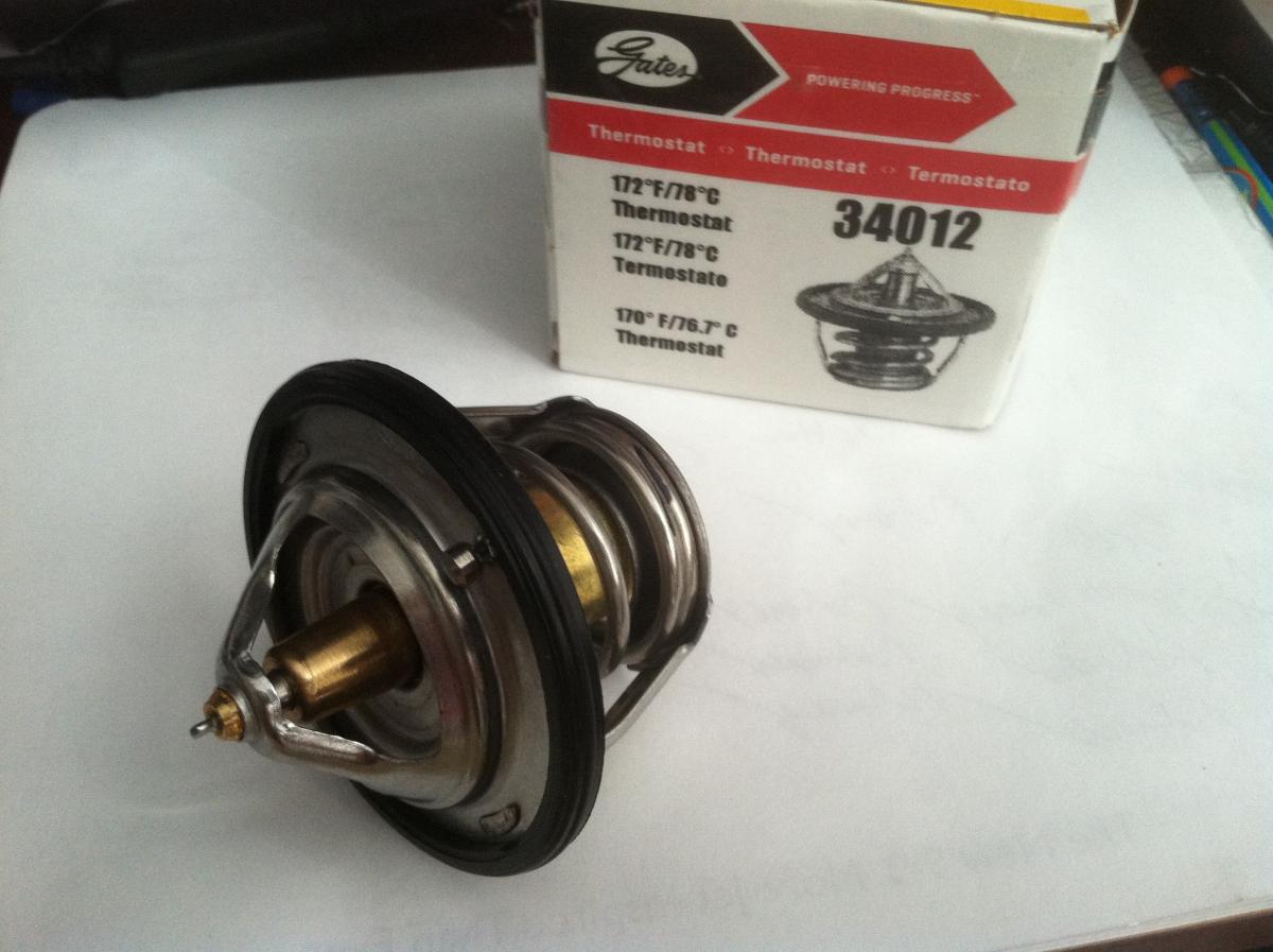

Don't kno if anyone noticed this, but when I searched Rockauto for this Stant one mentioned above, there is listed also one from Gates (#34012) which at least in the picture is identical, for $9.90. I called them and the woman said there's no correlation between use of same pic and that they are necessarily made by the same manuf, as any product sold may be supplied by various original makers. I don't suppose anybody's ever tried the Gates one? Thnkx

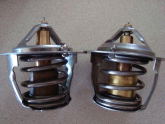

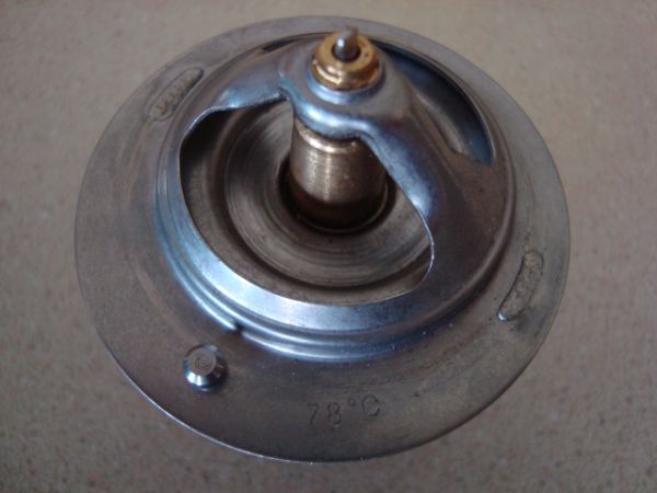

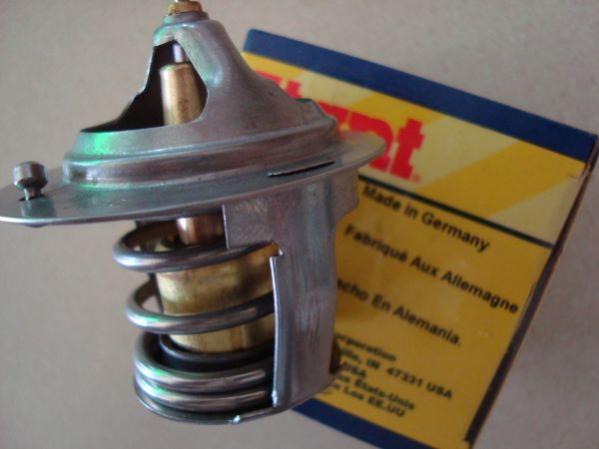

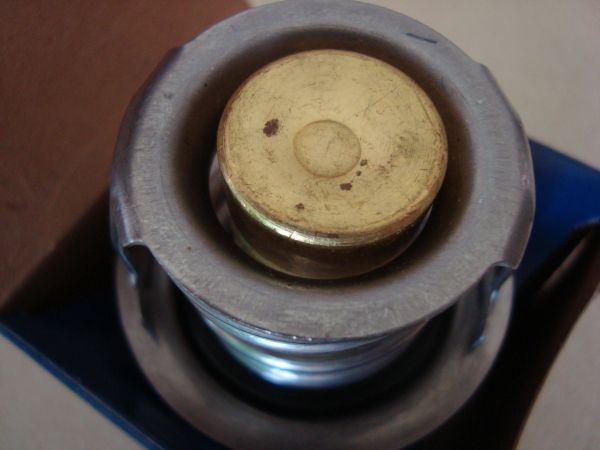

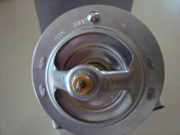

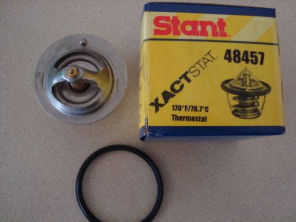

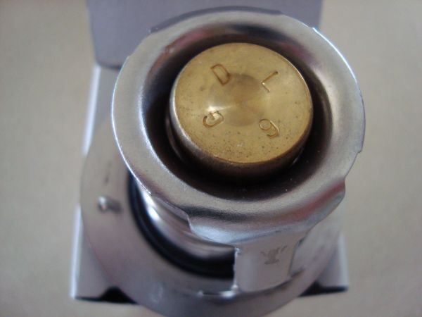

Hi all, just received the Stant "xactstat" 48457 from Amazon.
Have concerns about using it because..."Made in Germany" is on the box, "78°C" is the only stamping I can find on it (no emblems), and only has two tabs that attach cage to the mounting plate instead of the four on my old one.
Anyone else get one like this? Vendor switch? Advice?
Hopefully thumbs for illustration show up.
Thanks!

OK, mine differs from yours in only 2 ways that I can tell, the box says made in japan (in 3 languages like yours) and the 78*C marking is on the other side of the 'tickler'.
mine even has that offset dimple in the brass on the bottom of the 'wax filled slug' or w'ever. same construction and shape.

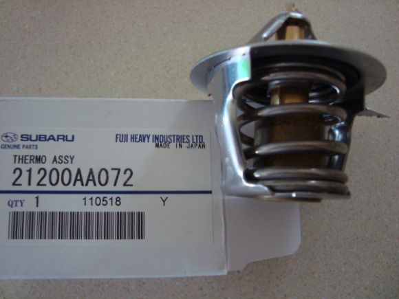

Stopped by the dealership and had a look at the Subaru part. They matched an online dealer price, so I picked it up there along with the gasket. Compared to the Stant product, there are cosmetic differences, which may not have an impact upon functionality / performance.
Peace of mind and all else considered, I believe the Subaru thermostat is worth the $8.00 above what I paid for the Stant product, and will be using same when installing the new pump.

I'm sure the German one would have been fine. I've seen a few variants of the "OEM" EJ thermostat and as long as they have the same opening diameter, the machined jiggle pin, and the large diamter spring that we are all used to they have worked without issue. I've installed tons of thermostat's and this has been the case 100% of the time. I've seen at least three variants of the OEM design and all have been fine.
The one's that are a problem have a smaller diameter opening, a weak/small looking spring, and often no jiggle pin. These are the "domestic" equivelents and they aren't designed with cold-side control in mind. They are desiged for hot-side control systems as used on almost all domestic cars and trucks.

I got one from Amazon.com about 2 months ago and it's also made in Germany, just like the one you got. The only difference is that the temp carved on the t'stat is 170 F, not 78 C. I put a 2-year-old OEM unit and this new German one in hot water on the stove. This new one opened a tad sooner than the OEM which makes sense - 170 F is a tad lower than 78 F. I installed this German one on my 96 2.5 and have had no problems.
