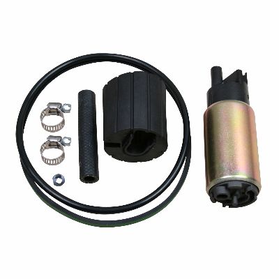

I'm not sure exactly what I'm looking for specs wise for a fuel pump. Will this work?
Airtex Master/Fuel Pump
4
Part Number: E2158
Fitting Size: Outlet -.348 in.
Fitting Type: Inlet - filter, outlet - hose connection
Gallons Per Hour: 45-55
Pressure Rating: 85-95 psi
4
Part Number: E2158
No.
That's an intank pump.
It doesn't have the right type of connection at the inlet, and it probably has a overflow drain, so it will be spurting fuel out the bottom while running (fine for in-tank, not good for external;) )
