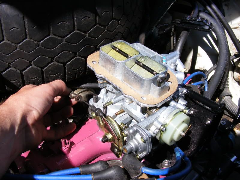

Well I just put a weber on my wifes 88 gl Wagon automatic.The stock one's butterfly had too much play,so that was that..I got the weber off Craigs list for $150 ,had some extra jets.I got the 2 piece adapter from redline and all is installed and runs good.The idle could be better but I have a good start.Here's the weird part.The choke mecinism is on the back side,by the spare tire..all the adjustments are there too..To hook up the throttel cable i had to set it up to pull on the down side of the hatochi?? wheel I installed.This is on the passanger side just like all the other ones I have worked on.So what kind is this one?? And ya know I think the hitouchai carbs are ok.They last 200,000 miles before they crap out.i always try to use a used one if i can find one.Cause if they work ,hey they usually last.. sooo any thoughts about my backwards webber?? OSF Todd:banana:

So what do ya think???It was off a vw

Probably a DfEv rather than a dgev. Reversed controls. Similar Weber in the area for sale which brought me here for research. This is correct?- it works but backwards control points.?

Hey Key,I have been fine tuneing it and it runs great,...but the throtle "disc" i took off the stock carb goesclockwise not counter clockwise.It took some messing with and i haven't got the cold idle to work yet.On the stock throtle disc there was a keyed hole that held a small 90degree bent rod that hooked to the cold idle "stuff". I am thinking of putting the stock throtle disc back on but that would involve adapting the subaru throtle cable to conectect it...like burning the cable so it won't fray and then get a set screw thing to hold ity in place,,,so that where i'm at...Have a Smooth New Year...Todd:banana:
