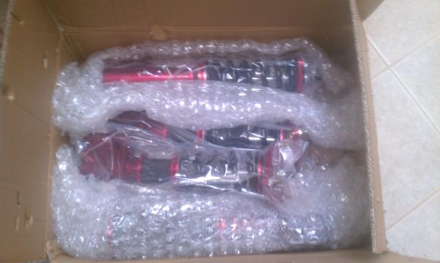

I've installed coilovers from an impreza. Any other ideas anyone?

There godspeed coilovers fully adjustable for an impreza. I installed them and its sitting pretty low. Almost scrapes everything. So yea need to adjust them.

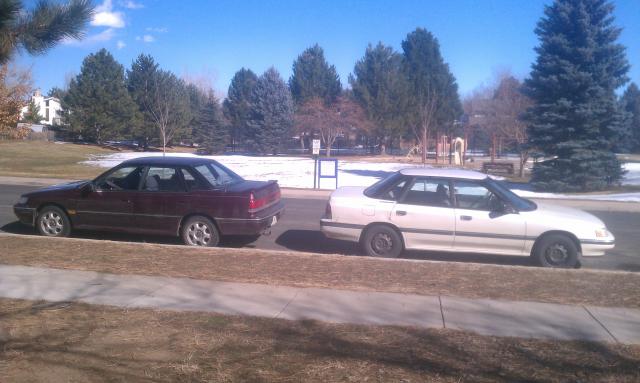

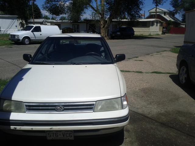

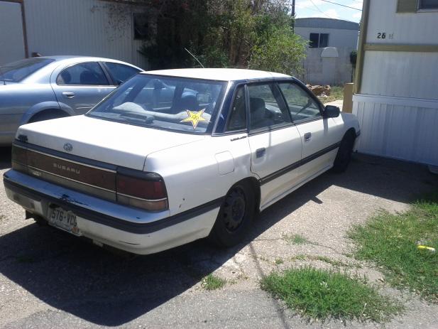

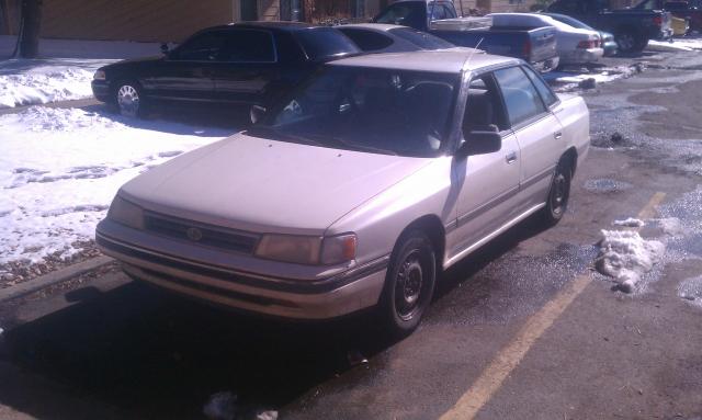

oh and here are a few pics of my car :D
