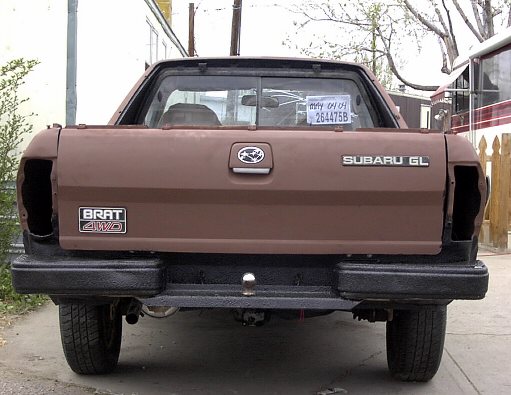

greggbrat Posted March 31, 2004 Author Share Posted March 31, 2004 This is the photo of the bumper installed. The bumper is going to get a good coating of Rhinoliner. Bumper hitch and everything! This came off a 79 chevy luv pickup......which was made for Chevy by Isuzu. Perhaps all the little chevy/Isuzu trucks have this same bumper. Gregg Quote Link to comment Share on other sites More sharing options...
PHATBRAT Posted March 31, 2004 Share Posted March 31, 2004 That looks like it belongs there. Maybe an inch higher however, much better than stock. Good find Quote Link to comment Share on other sites More sharing options...
greggbrat Posted March 31, 2004 Author Share Posted March 31, 2004 When I drilled the holes in the bumper support brackets (which came off the donor vehicle using a grinder) I didnt take into account that there was a little bit of play in the bolt holes. If you drill the holes just right it will sit an inch higher. I dont even know what the original bumper on the brat looks like........mine was a mangled mess from a bit of rear end damage. Quote Link to comment Share on other sites More sharing options...

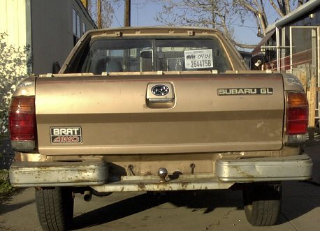

greggbrat Posted April 2, 2004 Author Share Posted April 2, 2004 A nice coat of rhinoliner makes all the difference. here is a photo of the bumper the way it should look. The hitch is a wonderful addition. This brat has gone through some major body work and rust removal. The Chevy Luv bumper is on, its primed and ready to be painted. Any suggestions on color? It used to be a gold color and it has a brown/tan interior. Thanks, Gregg Quote Link to comment Share on other sites More sharing options...
