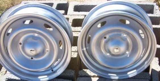

stinkydogfilms Posted October 29, 2012 Share Posted October 29, 2012 Will these fit on an 86 Brat? Any problem with disc brakes? Quote Link to comment Share on other sites More sharing options...
the sucker king Posted October 29, 2012 Share Posted October 29, 2012 those will fit your brat, there are no fit issues that I know of, have never actually mounted them, but have seen them used on gen 2s. I have a set of five of these I wanted to sell or use myself, but I have since learned that they are hard to get balanced, as the center holes are not true center holes and are too small for modern balancing machines. I am planning on taking them to a machine shop and having bigger center holes drilled. I won't get to this for quite a while I suppose, and I would love to hear from you on how you deal with this if you end up using these wheels. Quote Link to comment Share on other sites More sharing options...
the sucker king Posted October 29, 2012 Share Posted October 29, 2012 Also, they take some pretty odd lugnuts with a dished washer. If you don't have the lug nuts I can send you a pic of mine so you can get the idea of what needs to happen. Quote Link to comment Share on other sites More sharing options...
turbosubarubrat Posted October 30, 2012 Share Posted October 30, 2012 i have been running 14 inch aluminum peugoets with 195/75/14 tires with no problems besides the front will rub on sharp turns that will be fixed once i finally get it back on the road because im restoring it right now, you fix it by adjusting the suspension up front which is two nuts that you adjust about a inch out and it will be fine, but all this depends on tire size and if those are 14 or 15 inch rims i haven't had any problems with the rim, lug nuts, or hub size i have different lug nuts than what came stock for stealies(open lug nuts) maybe i have a set that are for the subaru aluminum wheels(closed lug nuts) but they work for all my rims Quote Link to comment Share on other sites More sharing options...

Subruise Posted October 31, 2012 Share Posted October 31, 2012 do make sure those are not the 390mm pug steelies. youll be pissed if they are. Quote Link to comment Share on other sites More sharing options...
