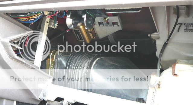

I'll measure the temp on the heater core next time I drive. I took the AC evap box out. A tip from Woods Wagon. It was oily and really dirty where the expansion valve had leaked/seeped over the years. Air flow wouldn't have been great over it.
Anyway, I hit it one time and got 143* F on the heater core. That will probably go up now.
Posted Image
Here's the AC Delete factory box from an '88 DL wagon.
Posted Image
I'm expecting hotter heat now.
