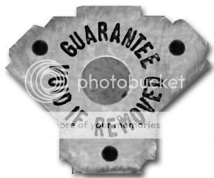

If you've got the valve covers off look for heat tabs, usually placed lower/center on the head when a head is remanufactured. The center is in contact with the head and melts at 260* F.
Posted Image
The adhesive used to install the heat tabs is good for 350* F. I had a now scrapped EA 82 with 120,XXX miles on it. I was the second owner if you don't count the dealer where the car was traded in.

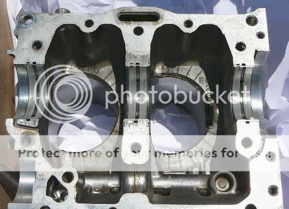

It got so hot it split the bore in #3.
Posted Image

Here's a real problem with the EA 82 blocks. Siamese bores. This violates two physical laws right off the bat. For a cylinder to be perfectly round it has to have consistent wall thickness, and equal temperature all around.
When these are overheated, damage is done. And old cars get driven home anyway.
