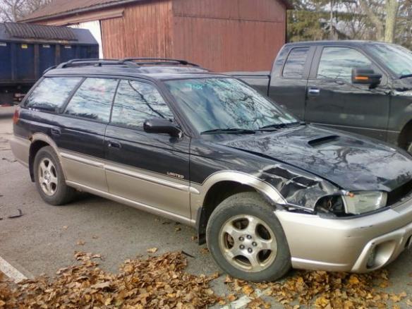

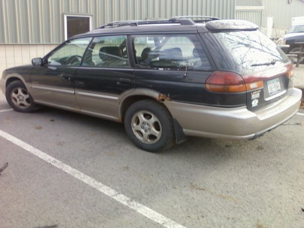

I really got on here for advice on how bad the rust is (cosmetic, structural), what I should do to thoroughly check it out (pull up carpet? Anything easier?) ... what I should do to repair it (fiberglass/bondo or metalworker?)
I tried snapping the worst of the rust.

Well... hard to tell whether you got ripped off without knowing the price, but right off the bat I can tell you it looks like a typical midwest car. And one that wasn't washed regularly, at that :/
The rust you show behind the wheels is almost normal for Subarus in the rust belt. If that's all the rust it has, I don't think it's that bad. You need to have the codes read to see what seems to be the problem with the car, and make sure the car 4WD isn't binding (go to an empty parking lot and drive the car in tight circles a few times, see if anything weird happens).
Now... did you check the car's history (i.e. Carfax) ? The front of the car looks almost too good to be on the same vehicle with the rust behind the rear wheels. I would ask whether the timing belt and head gaskets have been changed, too.
[EDIT] Checking the pictures, it looks like the two rear tires are different brands. That's usually not so good int he long term with these cars.

That's a $2,500 - $3,500 vehicle.***qualifying statements coming
$2,500 it would sell very quickly.
$3,500 it would sell over a longer period of time or right around early tax season when folks are temporarily rich and need a car immediately due to wrecking in the snow.
*** Areas matter - south east you're looking lower end, in Subaru rich areas you're looking at higher end or even surpassing $3,500...although a lot of the higher priced Subaru areas (Denver, Northwest) don't have rust so this one would stand out as a blemish.
Dealer prices can command higher prices, some of them smoke crack.
I see your concern, but I have a hard time calling that "ripped off" when the rust hole is that huge. Did anyone look at that car before purchase?
Rust repair - don't even bother doing it cheap, quick, or improperly, it'll return in a year or two and get worse. The metal needs cut out and replaced. At a body shop it's going to cost sick amounts of money - that would literally be like $1,000+ to repair at a shop properly....highly cost prohibitive.
If you can do it yourself and don't need a show room look - it's actually not too bad and costs little in materials/parts. More info and a picture of really bad one I did earlier this year (also a 99):
http://www.subaruout...panel-rust.html
It's close to show the imperfections really well - i just cut it all out, welded in new metal, filled, painted with NAPA $20 paint, bought some online 2 stage clear coat for $20, quick and easy. I didn't worry about it being smooth or factory painting. So yeah it looks rough but it also doesn't look bad from a distance and it's done right at least. Car wasn't worth tons of time/money but it's worth not having rust again in a year.
I hate to say it bu the body metal, while annoying is just a sign of the underneath probably. It's not threatening or dangerous, but that rust is going to suck to work on, future jobs will have hte possibility of being a debacle - axle nuts, ball joints, tie rods, the strut top mount bolts are going to round off without careful attention - suspension bolts/nuts, timing cover bolts, all the hose clamps will never be reusable, they're just going to twist off, exhaust manifold nuts will never come off the studs - they are now bolts (but that's like every car, literally in the rust belt), brake caliper slide pins are likely to be rusty, none of the exhaust will be easy to work with and the front flange and maybe somewhere else is more than likely going to break at some point, those things do all the time.
you should go ahead and do the brakes right right now - get all new caliper hardware - slide pins, boots, and pad clips - they are always rusty and cause the pads to hang, just be done with it now and have the brakes be easy maintenance over the rest of the life of the car. Rockauto is a great source for cheap brake parts - almost doesn't make sense to skip that step.

$950 is/was a good price, if the motor runs good, and shows no signs of head gasket problems.
Yea, do bondo work, spray paint, and call it a day on the rusty areas. It is not reasonable spending good money at a body shop for rust repair on a $950 car.
If you can't find out when the last time that the timing belt was replaced, then it is prudent to change the TB, and may as well replace the water pump, seals, and pulleys, while it is apart. If not done, a broken TB will ruin the valves, and create an unpleasant repair bill.

It's not great...but not too bad either.
I lived in Wisconsin for 5yrs.......and had a couple of the rustiest subarus on the road.
That Impreza isn't that bad.
one thing to check though is the rear subframe where the rear lateral links bolt in. Make sure that area isn't rusting through.

Up here in Maine I always say that a running driving car that passes inspection is always worth at least $1000.
That car wouldn't pass inspection because of the rust holes. They likely go through into the trunk behind the trunk carpet. It's not a huge deal to fix, but it's gonna have to be done.
With that, if it runs and drives fine. I'd probably spend 950 for that, I don't think it's a half bad deal.
It has the 2.2L engine, so you don't really have to worry as much about the head gaskets or bottom end failures. The 2.2 is a pretty robust engine.
I'd likely do the timing belt asap, that breaking will definitely ruin your day.
Overall, I think you made out alright with it.
