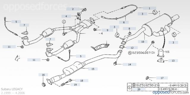

I would like to find the stock rear O2 sensor location and picture if i could. Haven't gotten anything from google images yet.

[QUOTE.....I would like to find the stock rear O2 sensor location and picture if i could. Haven't gotten anything from google images yet.[/QUOTE]
From Opposed Forces
O.

[quote name='Fairtax4me']My guess would be someone replaced the rear sensor and stripped the threads out of the bung. Probably cross threaded the new sensor or the threads pulled got chewed out by the old one. What better way to fix it than with a welder right? [/QUOTE]since the front two exhaust runners from the head ports are both cut and have new straight pipe welded in for a few inches it's obvious this thing saw some work and your guess seems likely.
[quote name='ocei77'][QUOTE.....I would like to find the stock rear O2 sensor location and picture if i could. Haven't gotten anything from google images yet.[/QUOTE]
From Opposed Forces
O.[/QUOTE]thanks O.! i looked at that pic and the O2 sensor was just off to the side and avoided my notice. when you posted it i figured i must have missed it, thanks. that's about where mine is. i thought it was more central on the converter that looks more to the side but probably same.

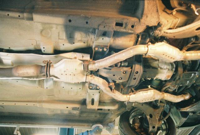

Only other alternative is like my 04 BE. It was a Ca. emissions (PZEV state here).
Although it was an H4 it borrowed the headers and exhaust from the H6.
It had a total of 5 O2 sensors!
In attached pic you can see the 2nd sensor just behind the cat, in front of tranny support crossmember.
O.
Looks like there are:
5 O2 Sensors on 04-05 H6's
3 O2 sensors on 01-03 H6's
link showing the difference from an online Subaru dealer:
http://www.subaruout...r-location.html
