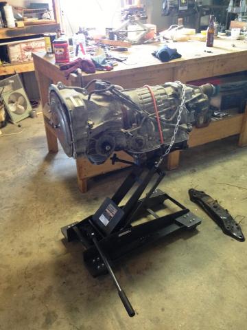

Had to modify the transmission jack and do some judicious tilting, but it's out.
I had to put 2 pieces of 12x2 under each jackstand and lower the rear to the ground.
The trans jack (with the extension ears I added so the pan would not hit) is about 9" high fully lowered, but it was worth every cent getting it out, and will doubly be so going in.

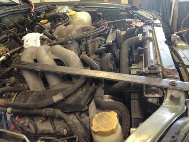

I bolted a 1/8th metal bar between the radiator support and a mount on the intake, motor stayed nice and stable.

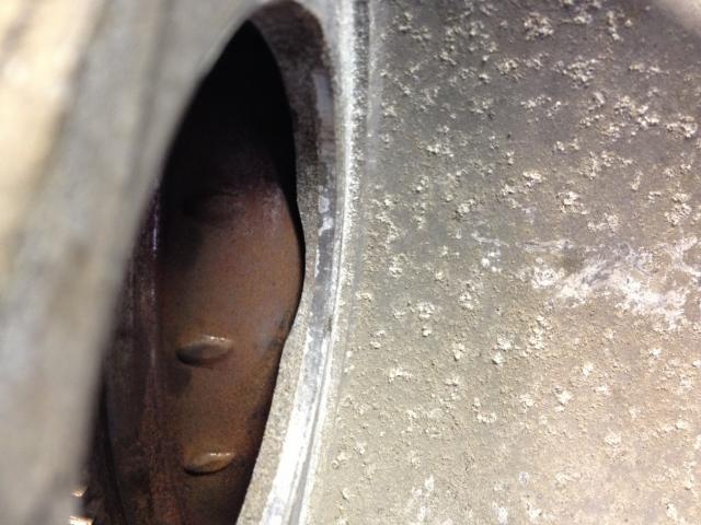

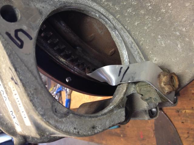

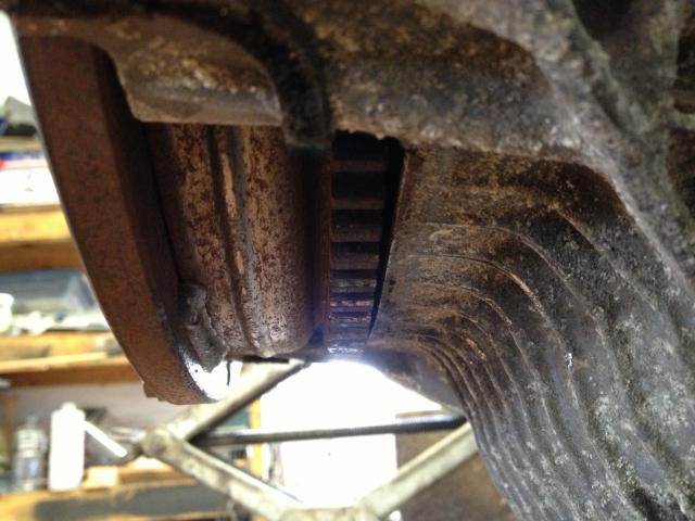

What a seated H6 converter looks like, and a little widget I made to hold it in place.
Also where I installed a bar to hold the engine at the proper angle.

Just a pick of the horrid-freight 800lbs trans jack, and 4 of the 5 holes in the side of this '04 H6 4EAT are not in my '03 4EAT.
The circled hole is the only one of the 5 on the '04 front housing that is on my '03.
Edited by CNY_Dave, 28 January 2013 - 09:56 PM.
