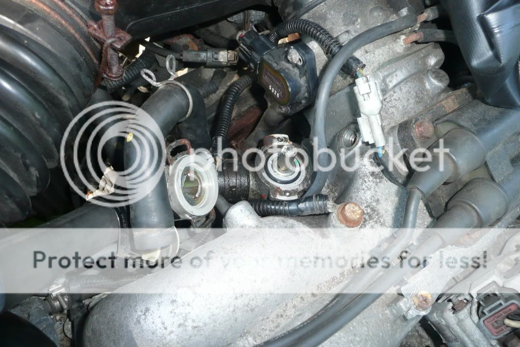

Thanks for the suggestion. Is it easy to remove the cover, will I need special tools? Is it easy to put back?
Here's a thread that discusses it, no special tools but the cover may have some glue holding it in place. pull the cover straight up iirc, there is a strong (and brittle) magnet that wants to fight that.
http://www.ultimates...ead.php?t=98281
Here's what the IAC looks like with the cover off
http://i444.photobuc...25/P1040145.jpg
