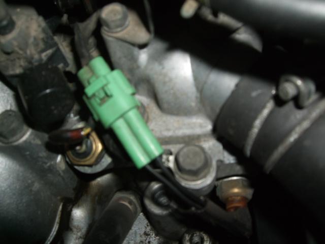

#8 kerandt
kerandt
    USMB Regular
  • 75 posts
  • Missoula, MT
Posted 13 January 2013 - 07:54 PM
Look on the thermo housing, lower, same side as the single spade connector. As stated green plug with two wires.
