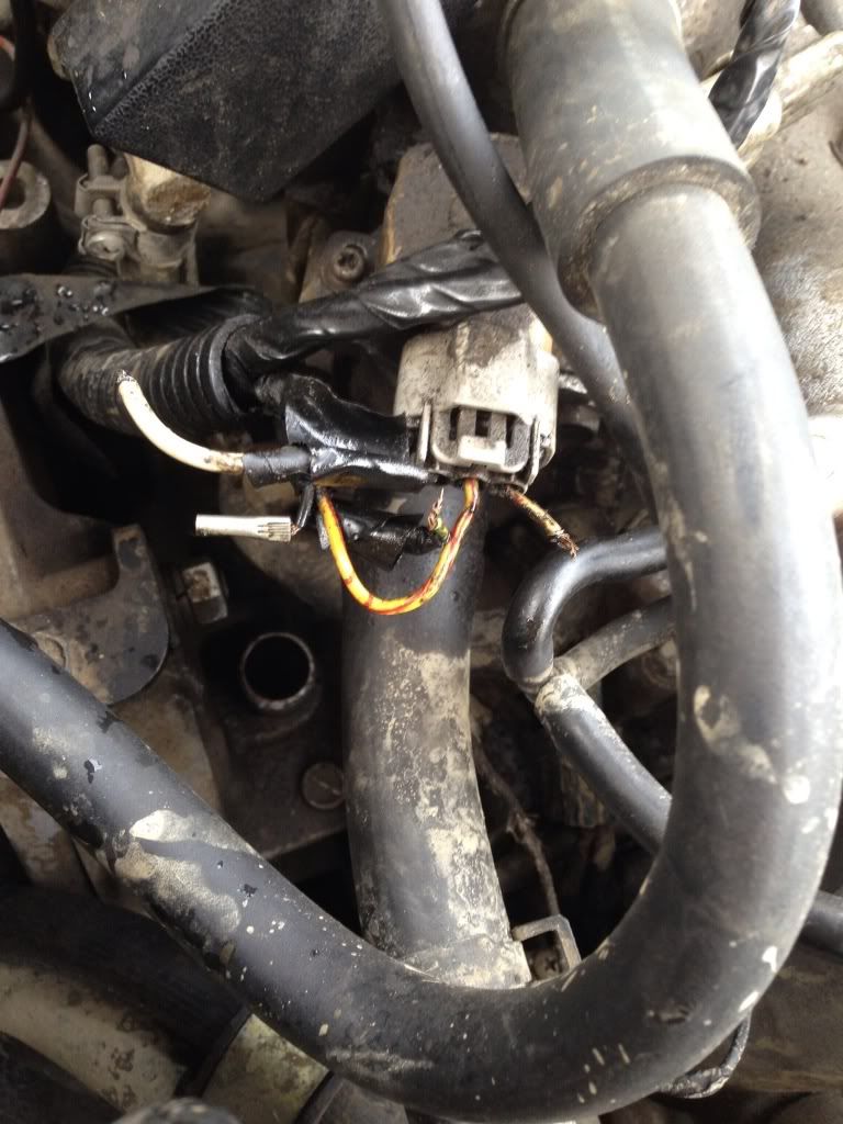

Ok got the car running again. It is still burning oil so I am going to have GD swap out the block and clean up the wiring. In the mean time can someone tell me what this sensor is? It has two wires that aren't used and there are two wires from the pigtail next to it. When I touch any of the wires together it either dies or increases idle. It just right below the pcv valve. Also, what is the port just behind the passenger side head close to where the transmission mates up? It is right below the sensor I referenced. As you can see in the picture it is wide open.

#44 Gloyale
Gloyale
    It's a sickness
  • 10,840 posts
  • Corvallis, OR PNW
Posted 17 March 2013 - 09:50 PM
That's the IAC.
Someone has cut wires to it.  Perhaps in an attempt to control idle?
I tapped in to those wires to control idle on my wheeler.  Disconneted, the IAC is about half open.
If the hoses to that are routed wrong you can suck a ton of oil through the intake.  Espescially with the Crank vent down there WIDE OPEN!!!
I am pretty sure between those 2 things you are sucking oil through the PCV system, and you've got a horrible unmetered air leak with that crank vent open.  That is suppose to T into a port from the intake, and then go to the PCV.  the port on the intake tube is probably open too.
Rick will correct it.

#45 Haight
Haight
    USMB Regular
  • 281 posts
  • Seaside, OR
Posted 17 March 2013 - 10:14 PM
That's the IAC.
Could you possibly link me to a picture of the proper intake setup? With the t and pcv routing?
#46 Fairtax4me
Fairtax4me
    Sooberoo
  • 13,031 posts
  • Charlottesburg, VA
Posted 17 March 2013 - 10:31 PM
The PCV hose to the block is just gone. That big port in the top is supposed to be the "suction" side of the crankcase breather system. That Would explain the oil smell and smoke you mentioned earlier in the thread.
Someone has routed the PCV line incorrectly, it looks like it is looped over to the intake tube and it should be going to that port on the block. It also looks like heater hose, which will not hold up to the oil vapor from the breather system. It needs to be Emmisions hose.
The wires to to the idle air control as already stated. Without those the ECU has no control over idle speed, which would explain the poor idle condition.

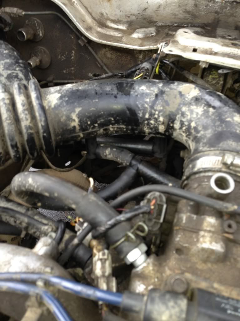

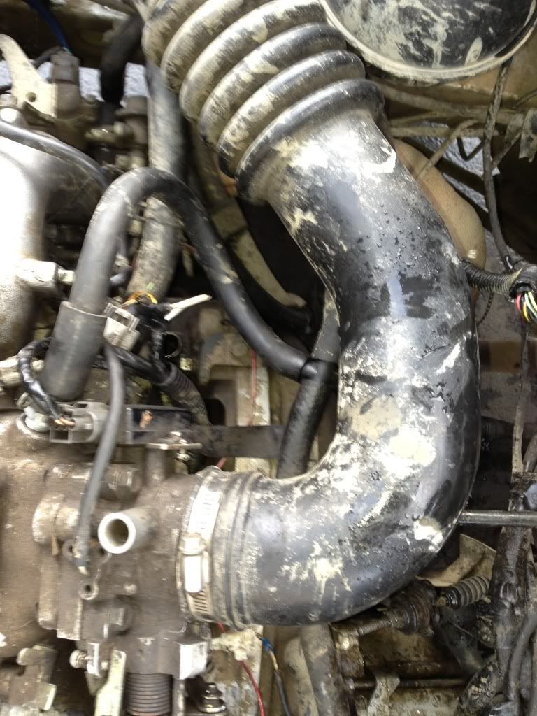

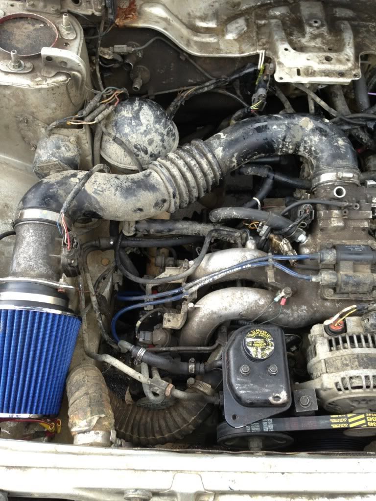

#49 Haight
Haight
    USMB Regular
  • 281 posts
  • Seaside, OR
Posted 18 March 2013 - 11:40 AM
I don't see any where on the intake routing that has a missing port. Is something here routed wrong? Where should the pcv hose connect?

#50 Fairtax4me
Fairtax4me
    Sooberoo
  • 13,031 posts
Posted 18 March 2013 - 01:46 PM
Yes it's routed incorrectly. The hose from the PCV should be going to the port on the block. The hoses from the valve covers should lead into the intake tubing behind the MAF sensor. There may be a T or other port on the bottom of the intake tube that has been plugged off.
As it is currently routed the engine is pulling in unmetered air (it has not been through the MAF sensor) through the PCV system.
That's hurting performance and fuel economy because the MAF sensor is not reading the correct amount of air that the engine is consuming.
