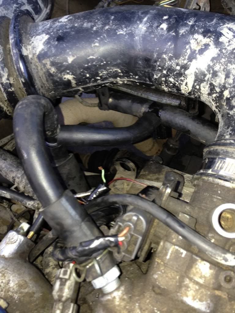

Is this routed correctly? Pcv to a T on the Crankcase breather. Crankcase breather to a T on driver side valve cover breather. I know it is shoddy. I tossed it together with parts I had lying around.

That looks correct. (For some reason I couldn't see the pic before).

The PCV hose to the block is just gone. That big port in the top is supposed to be the "suction" side of the crankcase breather system. That Would explain the oil smell and smoke you mentioned earlier in the thread.
Someone has routed the PCV line incorrectly, it looks like it is looped over to the intake tube and it should be going to that port on the block. It also looks like heater hose, which will not hold up to the oil vapor from the breather system. It needs to be Emmisions hose.
The wires to to the idle air control as already stated. Without those the ECU has no control over idle speed, which would explain the poor idle condition.
