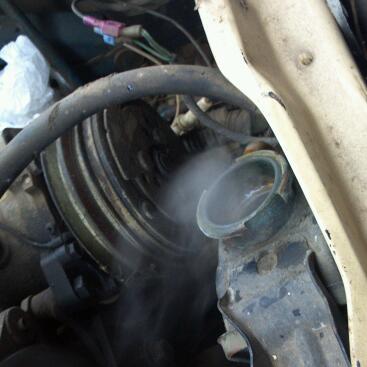

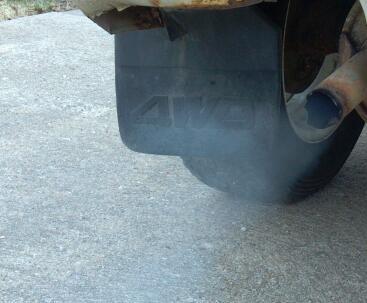

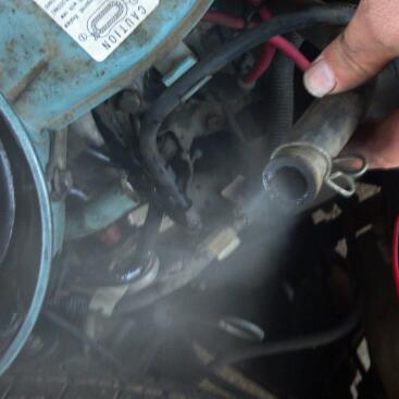

So i bought an 81 hatch ea81 4 speed manual 4x4 with 139000 miles yesterday. I drove it an hour home no problems. Today i go to fire it up and is smokes a little from the exhaust. I popped the radiator cap. Its gurgling water. Pretty bad. Also smoking and smells like fuel. Theres no water oil mixing. The car never over heats. The plugs are dry and clean. Also the rubber tube that comes from the passenger side head into the air cleaner is sputtering water and steam. My guess is head gaskets. Any ideas?? Also the car has sat for a year and a half before i bought it. Put a new battery and fresh fuel and it started right up.

Steam out of a radiator, does not mean anything because we don't know how warm the car was when you popped the cap.  Ordinarily, if it is warmed up, the coolant explodes out of the radiator and scalds your face.  Most people only do that once.  The vehicle may have had oil drain into the cylinder area through either the rings or the cylinder head gasket.  Cylinder head bolts can be retightened in order to clear up some problems.  Run it awhile to see whether the oil gets burned up from coating the cylinders/piston area.  139,000 miles is low.  It should be barely broken in.

I popped the cap before the car warmed up. When i got it off it gurgled out till i couldnt see any water. It had the steam the entire time. The car ran for about 20 minutes and the needle on the gauge was about a quarter the way up the gauge. The radiator had the smell of gas. Like someone pourd gas in it. Ill have to fill it with coolant and do the taste test.

sounds like headgaskets but if that engine is like the EA82, they have a coolant crossover pipe which can leak coolant into the intake manifold and get into the cylinders that way.

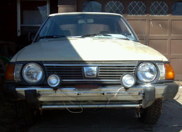

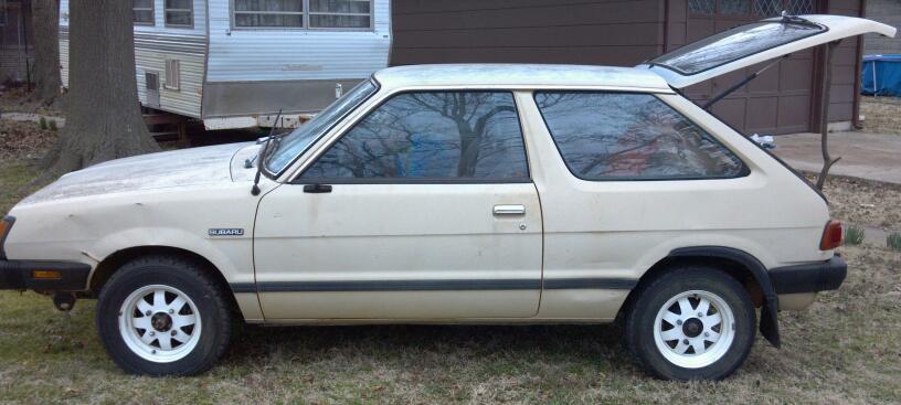

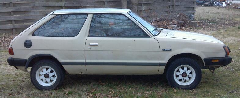

I figured id throw in a few pics. I havent taken pics of the inside yet.

Intake gaskets are $4 each.  You need 2.  My Subaru dealer is 80 miles away... they ship alot of parts to me.
I just picked up an '83 Hatchie last month.  I like the stick you use for the lift supports.  I found some at RockAuto for $13.  No more stick for me.

Ha! The stick was a temporary part. I was cleaning stuff out of the back. Came with four extra tires on the stock wheels. It was on the back.
