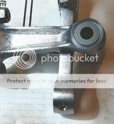

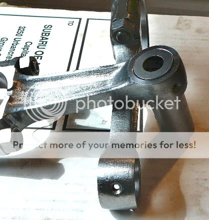

Man, I've done a lot of work on this, crunched the research. WISECO has an off the shelf piston that if I called them and ordered them without valve reliefs, would work great. Yea, I've got lots of numbers. Turbone I read that thread, got some thoughts will post later. I can do some pics now. Oh, I'm fairly certain I can fit an EJ20 factory piston successfully. And it wouldn't be such a bad fit. I can fly cut any valve reliefs. Depends on id there is enough dome thickness. Aftermarket turbo usually a quarter inch plus thick dome.
EAwithEJ_zps1973fb55.jpg?t=1380560461
SubaruEARodsEJPin_zpsad33f61e.jpg?t=1380
KGrHqJqQFDtWQkccBQ7wg12Yg60_1_zps0d22e09
Here's the specs on that Wiseco. Oh, scroll down and read the last sentence first.
Part Number: K588M925
Notes: Pro Tru Pistons; Sport Compact Series; Set of 4 Pistons; Recommended RingSet: 9250TX; Rings & Pins Included
Manufacturer: Wiseco
Dome Volume: -9
Comp Ratio: 8.35:1
Bore: 92.5mm
Stroke: 75
Comp Height: 32.66
Rod: 130.5
Gram Weight: 380
Product Category: Pistons
VEHICLE FITMENT
STARTYEAR ENDYEAR MAKE MODEL SUBMODEL CYL LIT FUEL FUELDEL ASP ENGDESG NOTES 1998 2011 SUBARU IMPREZA ALL ALL ALL ALL ALL ALL ALL Fits JDM WRXSTI EJ20 2.0L; 16Valve; DOHC; From 10/98 Production Date 2002 2005 SUBARU IMPREZA WRX ALL 2.0 ALL ALL T ALL 16Valve
